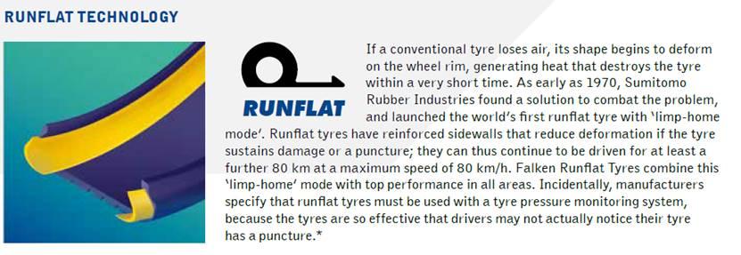

Well I asked Falken & had a reply, they have confirmed they are not run flat see below:-
Thanks for your mail and question.
Pls. let me explain.
We deliver our Tyre Falken ZE 914B as OE supplier to Toyota.
This specification is marked with an B on the end for Toyota OE tyre.
Also this tyres have a modified construction in pattern style like ZE914 Ecorun.
Tyres where we deliver to Toyota are no Run Flat Tyres.
All OE tyres to Toyota are standard tyres.
If tyres have Run Flat they must marked with:
See image file
Does the size code say R or RF?  The same size tyre is available as both standard and run flat. Perhaps you should check with Toyota?
According to Black Circles, there is no industry standard as yet to identify run flats from the tyre markings. Eg https://www.blackcircles.com/helpcentre/tyres/how-do-i-know-if-my-tyres-are-run-flat-tyres

Perhaps, but the Falken website suggested RF for their run-flats.

I asked the question because like bewA all the tyre websites showed they were run flat. However as Falkan said the important bit is the B after the 914. That's the designation for Toyota OE and they aren't run flat. Apparently they use the flattened circle as their designation, though I've also seen on web sites RF.
Run flat isn't mentioned in the manual like in the Lexus PeteB mentioned, which I'd have thought out would be if they were RF.
