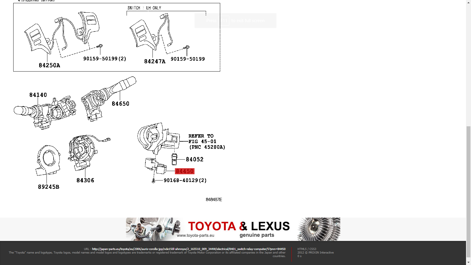

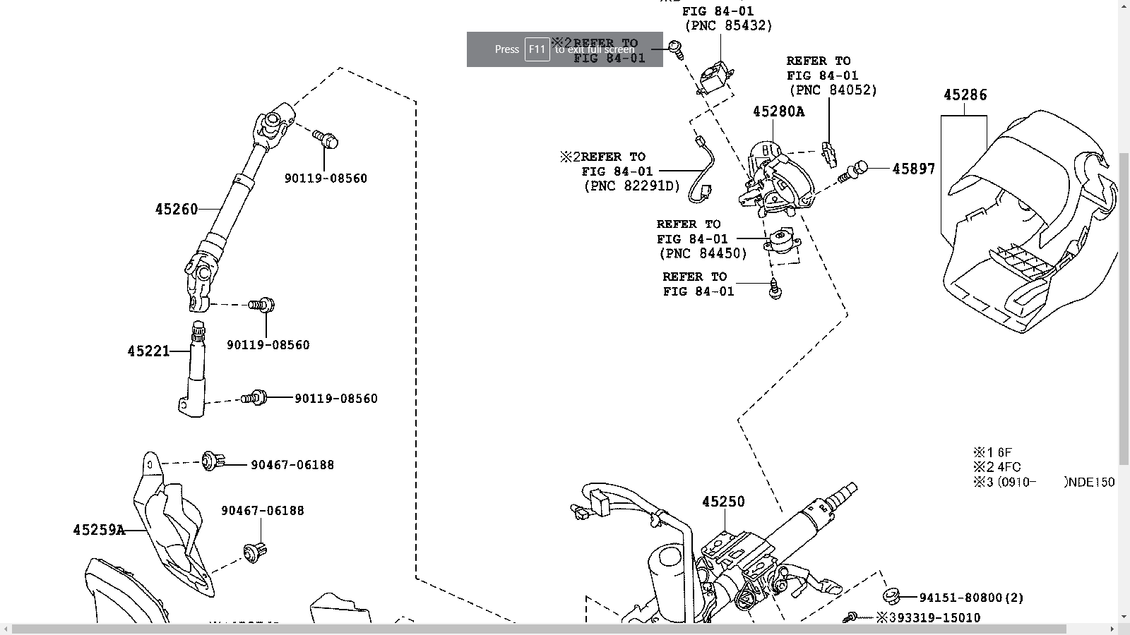

Fault description matches what happened to my old Avensis, a few years ago. The Battery was good and jump starting made no difference. All other items like lights central locking and radio worked fine. The ignition switch failed. Took about 20 minutes to change. Toyota was known for this failure, and when the switch finally gave up, I was only a short walking distance from the dealer.
Not sure if the Auris has a new design but I did a check on the part number which is shared with the Avensis T27, - http://www.japan-parts.eu/?parttt=&part=84450-12200&regi=EU&cars=ok
http://www.japan-parts.eu/toyota/eu/2006/auris-corolla-jpp/nde150l-ahmnyw/2_165510_009_344W/electrical/8401_switch-relay-computer/5?pnn=84450
image.thumb.png.17204a85ce308e82125b83a742c8d787.pngimage.thumb.png.4af4dd4b998ab4d322134f2c007cbff9.png
It looks like you just remove the lower steering cowling/cover, undo securing screws, then unplug the switch. This is only a guess looking at the diagram.
If I am correct then you will only need to buy the switch. If I knew another test procedure, like jumping the terminals of the switch to see if the starter works, I would let you know.
