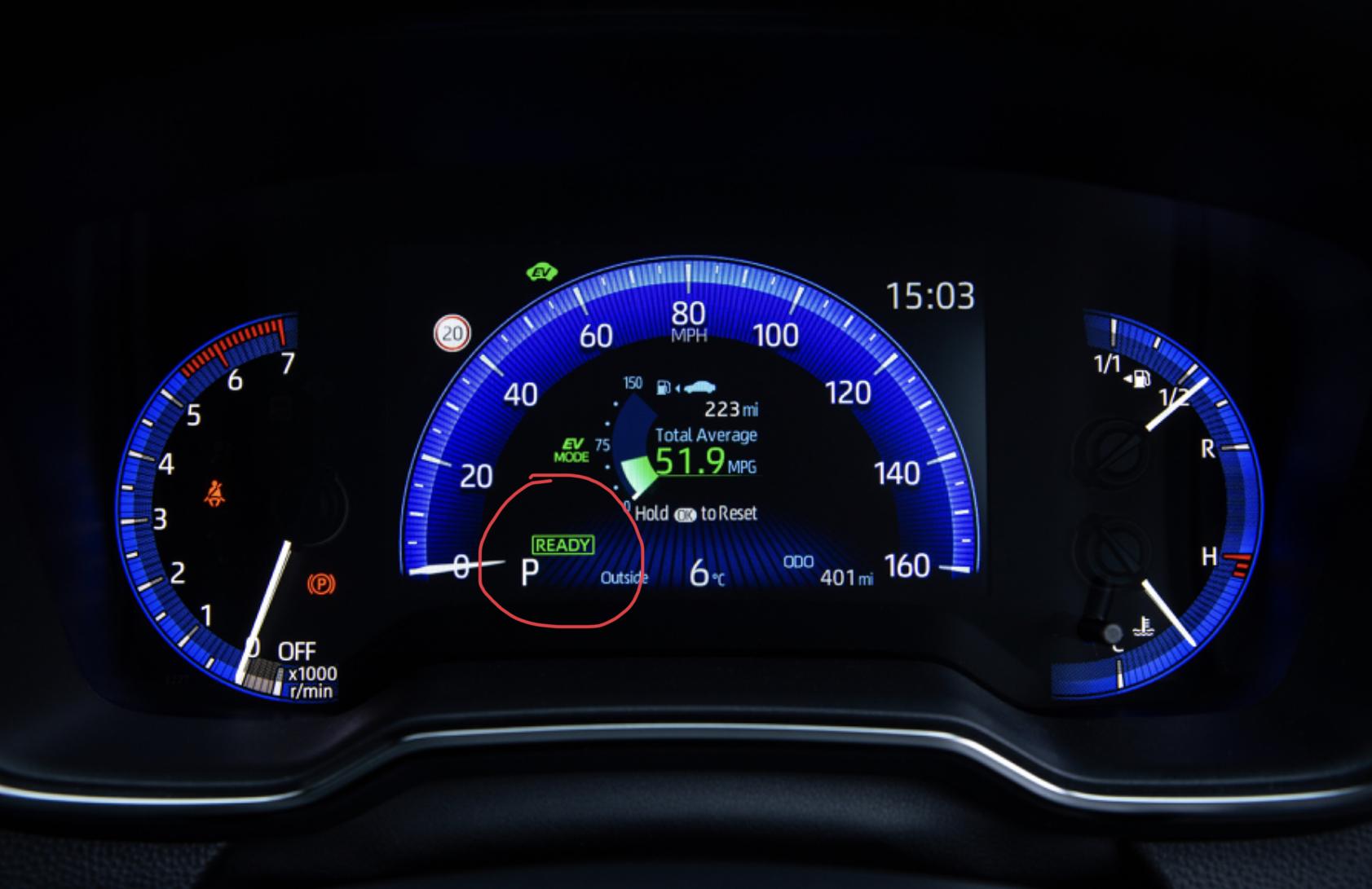

Hi, ready mode is when you press start button and your car comes to life ready to be driven. There should be a small green light on the dash showing “Ready”.

It is unlikely the hybrid Battery would be flat. In ready mode, the 12v Battery will charge from the hybrid system, and the engine may run for a few minutes every so often, but won't be running for the full 60 minutes.
