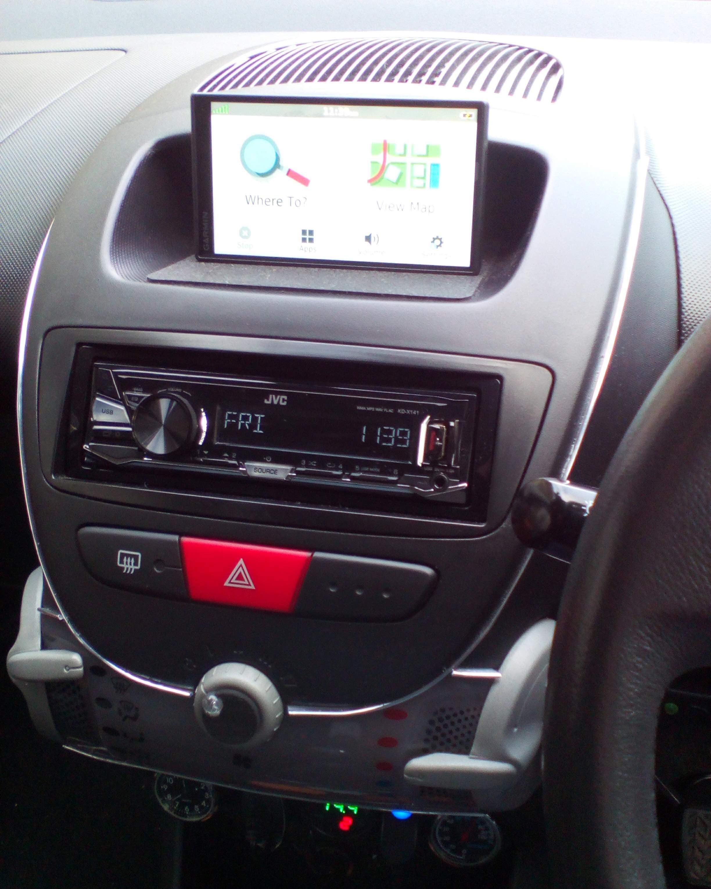

I changed the stereo for a single din JVC model with no cd drive, so I just leave a micro usb stick/stub with all my music loaded in and that looks much better than the original stereo.....Being a JVC it also came with the correct iso lead/adaptor but I just had to swap the red and yellow lead over (The lead had bullet connectors already fitted to allow this) to get the right positives going to the right places.
Whilst I was doing that, I got some mid grey headlight wrap and covered the heater control "bubble", underneath the stereo.  Now instead of a white area, I have a nice gloss grey area that I can see all the controls through and still lights up orange at night.  That job wasn't just as easy as it's a bit awkward but a rough paper template, a sharp knife, a hairdryer and a bit of patience gets you there.

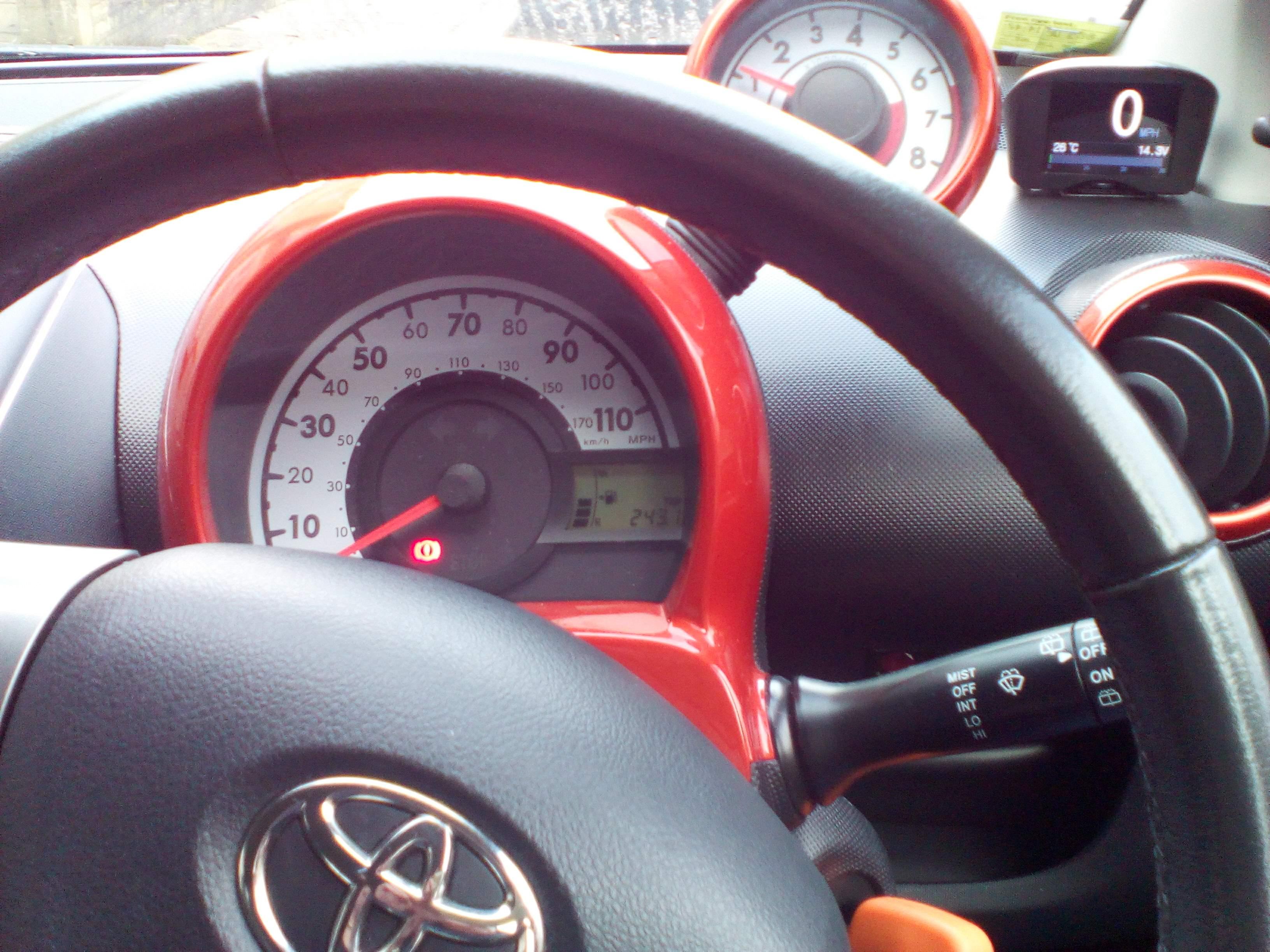

Apart from that, a front and rear Dashcam, an "Autool X60" fitted into the ODB socket to give me a "Heads up" speedo and coolant temperature gauge:

and a Garmin satnav fitted to the shelf above the stereo, with the lead run through the back of the shelf to make the job nice and neat and that's about it.  I haven't done anythig with interior lighting, so I can't help you there but I'm pretty sure that others on here have done something similar.

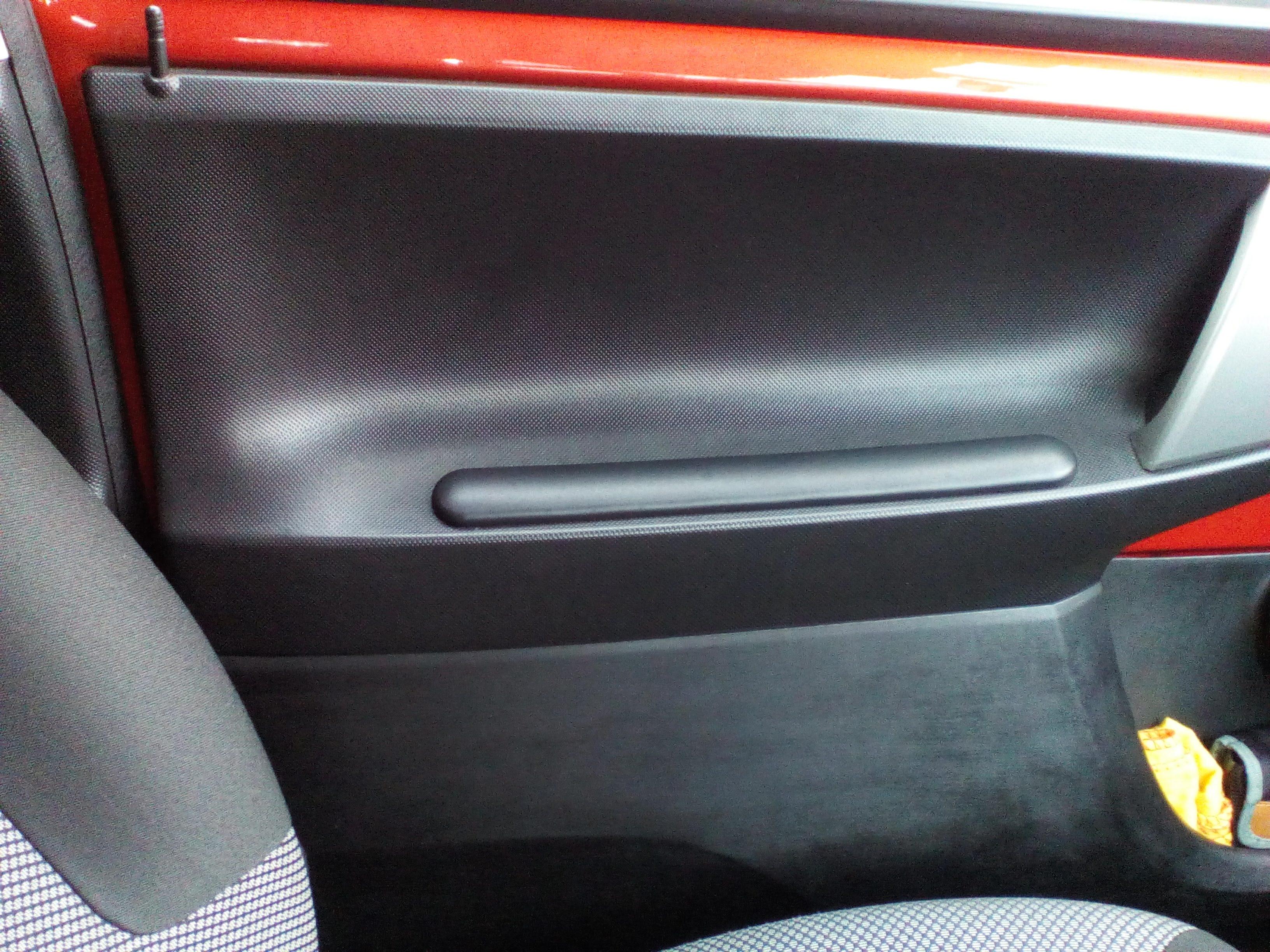

I don’t suppose you have a pic of these bumper protectors on your door card Rest do you? Sounds really cool actually.
And finally, I’ve never heard of Autool? Your link applies to a diesel I think. Do they do a petrol version? And how did you hide the leads etc?

Here you go:
Ahh cheers Agent orange, your Aygo must look sweet in red, id love to have a red Aygo, love red cars!
ok, so notice you have a 5 door version, I have a 3 door...I might need 2 bumper protectors per door as they are a bit long! I might consider it.
otherwise re.your Autool, are you sure that’s the x60? I ordered mine this morning only my model is round n cute to match the dials etc, but it’s an x60. They look pretty cheaply manufactured but at 25.00 smackers I thought I’d try it out!

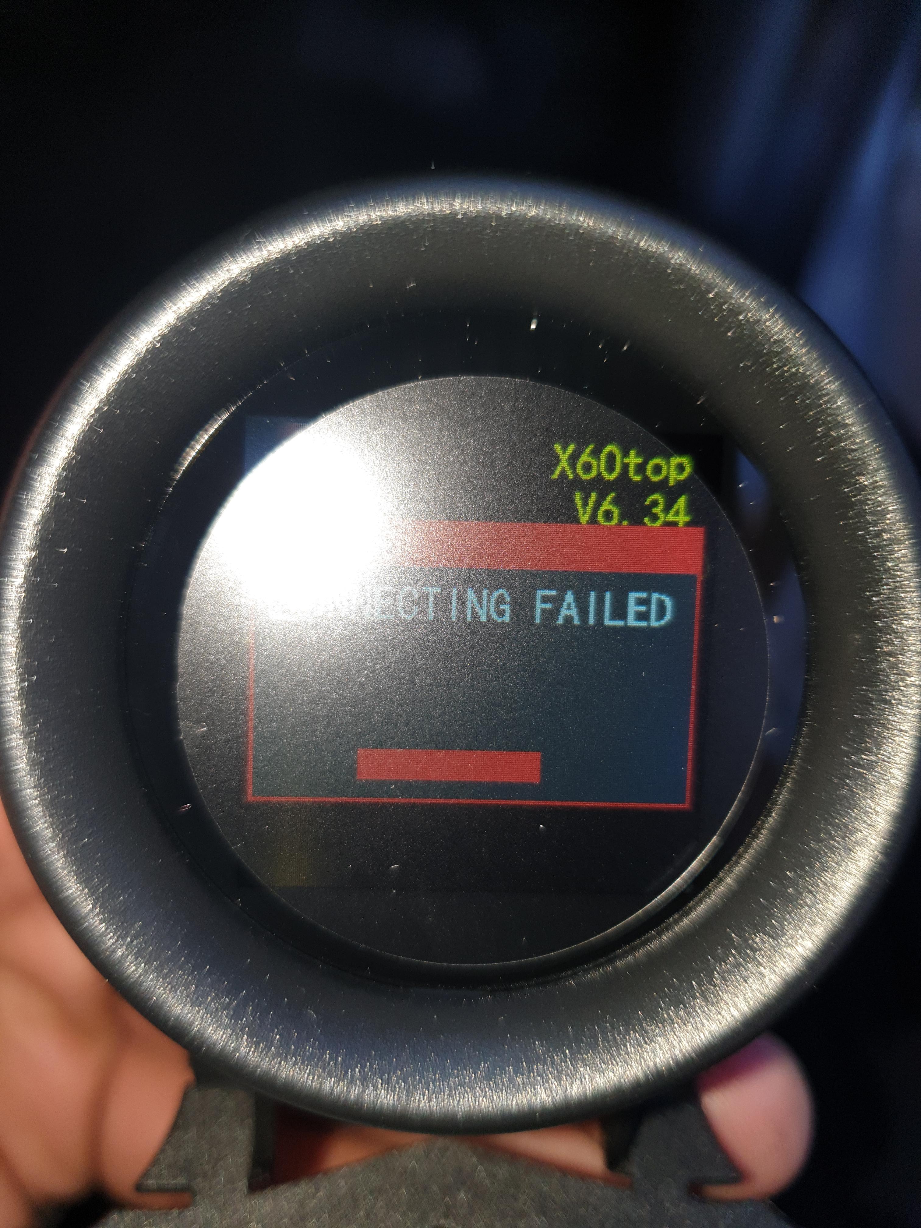

Morning All
Re.that Autool x60 I ordered, im having to return it to the seller today, tried connecting it several times yesterday only to receive a Connection Failed error. Cute device though but looks cheap.
