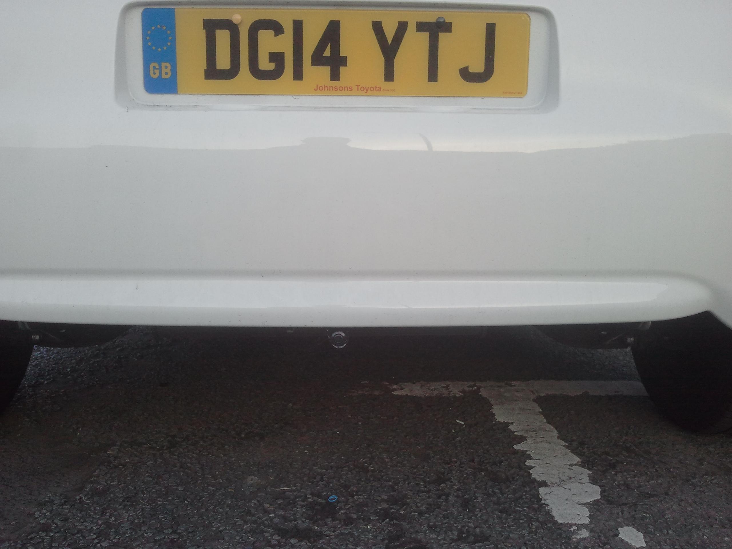

have you thought of a reversing camera
here is one i fitted on a 14 plate i bought
the camera is under the bumper and as you can see
through the windscreen in the video it is dark
The camera idea is good but is it too low do you think (I know it is difficult to choose a correct spot in Aygo), since it might get dirty very quickly due to its nearness to the road surface. Not to mention the splashes during rain. I would have thought that a camera attached to the upper edge of the number plate would be more appropriate from the dust and rain point of view. It would also mean removing the number plate temporarily to drill a small hole behind the plate to pull the camera wires. Your position avoids drilling hole.
i didnt want to drill a hole in the car as we bought it brand new in 2014
i fitted it in march 14 and used it up to december 14 with no issues
the car had been driven through the dry dusty months as well
as some wet months , in my own car when it rains i always need to give the
camera lens a wipe and mine is above the number plate so there
isnt an ideal place, during the daytime the image from the camera i fitted
is crystal clear and sharp and at night the image was still really good as you can see.
Thank you Eygo, that is a good news for all aspirants since it makes the installation easier.
