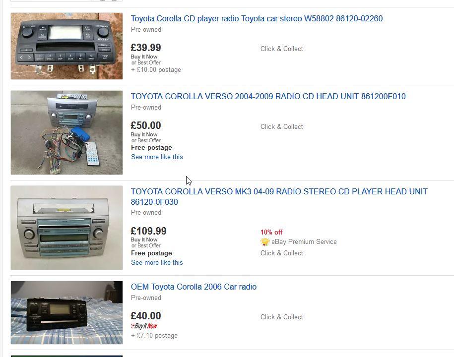

You can find such used head units  cheaply on ebay or the Audio /For Sale section in this forum where folk have replaced theirs for a more modern unit, probalbly cheaper than having yours repaired, if anyone would look at it ..?
Thanks for the reply. I don't want to get a new head unit and find out that the problem is elsewhere. It really seams to me like there's a loose wire but just can't pinpoint it.

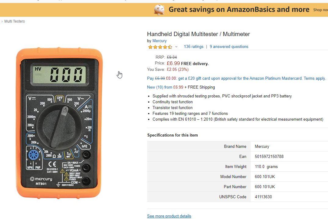

To test the wiring you need to use a multimeter connected between the disconnected speaker plug thats at the back of the head unit and  to the actual speaker terminals, once the meter is connected then wiggle all parts of the wiring you can get hold of and see if the Resistance changes.  Also move the door as where the wires goes across is a common failure point, thouhg unlikely to happen at the same time on both doors,   Repeat on all four wires to the Speakers
If thats not something you can do most auto electricians or anyone whos handy with their own multimeter should be able to help.
