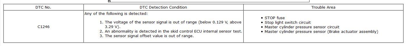

Should be DTC C1246 / 46 Master Cylinder Pressure Sensor Malfunction

the light came back on today and they have mentioned master cylinder pressure sensor

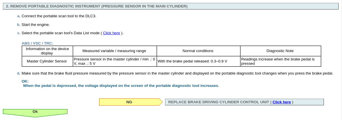

Since you said you have Techstream, you can try to do the check yourself.it
I dont know if the sensor is part of it, sadly the manual just says replace the whole part.
The sensor should be builtin into the device, you might be able to change it, if you are lucky enough to find it that is.
Check this video for a rought idea how it looks inside, i dont know if it's similar to the Toyota one, but on first glance they look somewhat similar from outside, so i suspect the inside might be similar aswell  https://youtu.be/rtuSNSeUvGY?t=211Here is the link from where i got the info, it should be applicable to your car https://corolla-club.ru/doc2/rm04f1ru/repair2/html/frame_rm000000xig012x.html
