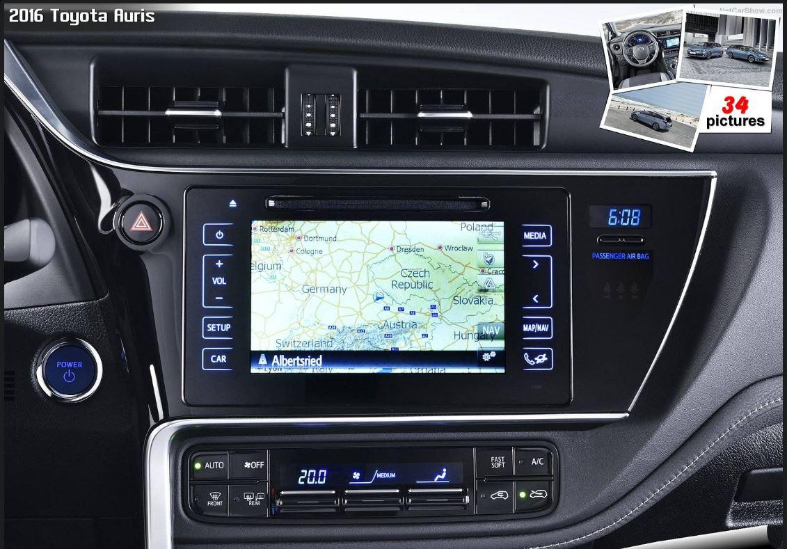

Hello guys.
I am the new owner of an Auris Touring Sport Hybrid, manufactured in 2016. The car is sol+ with all the stuff.
The problem I noticed is that if I click on the TALK button:
  1. a window appears telling what commands you can use, then disappears after a maximum of one second, disappears so quickly that I cannot read what it writes, or
  2. the message voice recognition not available appears.
The navigation is in English.
I had the phone connected via bluetooth.
Soft: 4.4.1.WH
I made an account on My Toyota, I putted the navigation id, that long code. Strangely, it tells me to download applications that I already have installed and an older software than it has already installed.
I went into a hidden menu, gave a factory reset, asked me to select the language, put in English. I pressed the TALK button and entered the voice recognition menu, I pressed the call button, but due to  the fact it was recently reset, I had no one on in contact list.
I connected the phone, saved some contacts and when I clicked on TALK again, surprise ... it doesn't work anymore. The menu appears and disappears immediately or says it is not available.
I tried again these morning. I gave factory reset, and it went into that menu. Then it didn't want to work anymore.
Do you have any idea why this is happening?
Thanks.
