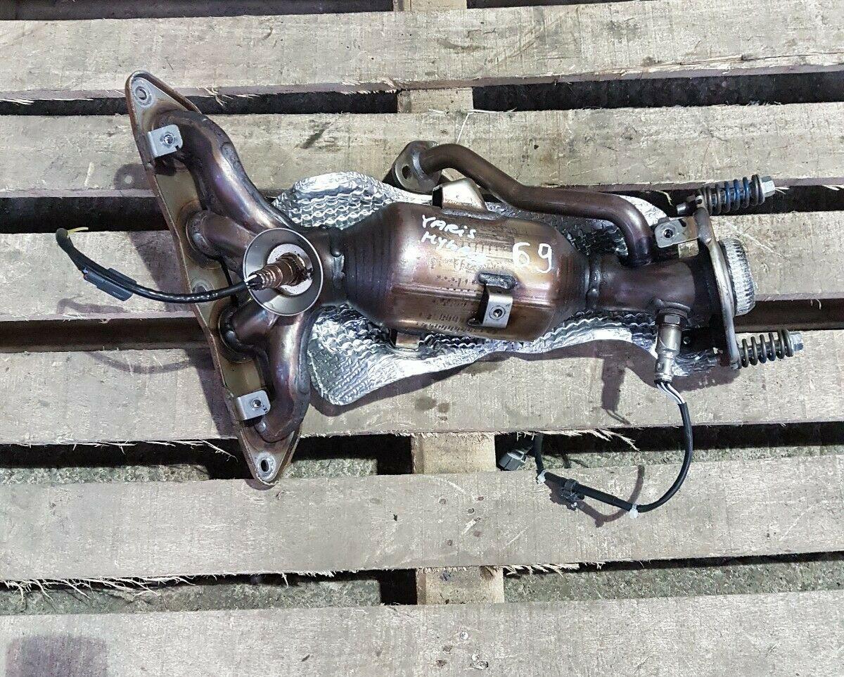

Do you know exactly where “tucked up high” is ?
I read somewhere that Honda were redesigning some of their cars to place the cat much nearer the engine, within the compartment in an attempt to reduce thefts.
Here's a Yaris HSD catalyst (manicat) off eBay. The cylinder head connects to the left hand side (so this part of the assembly sits highest when fitted), the rest of the exhaust attaches to the right hand side (the side that is the lowest side), via the two spring-loaded bolts in the picture.
On an Auris and Prius, the actual catalyst (with the white handwritten label on it in this picture) is an integral part of the next exhaust section. That section is on the other side of the spring-loaded joint, so it can be unbolted from the manifold via the two bolts shown, which makes removal too easy by far.
So on the Yaris, to steal the catalyst you are going to have to unbolt this whole component, unless you go crazy with a cordless saw or angle grinder, and then you would need good access from above through the bonnet.
