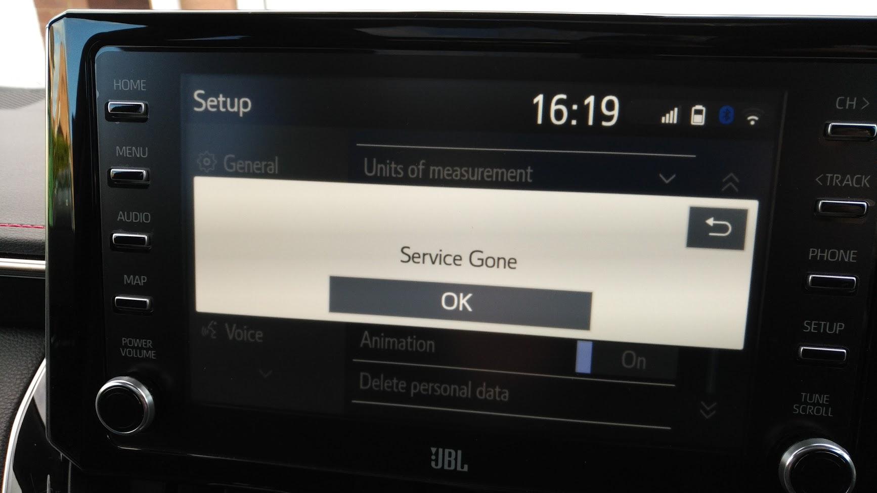

Hi all,
I suddenly get this lame message every time I start the car. That has never happened before, and I have not changed any settings as far as I know. Any idea which service, and gone where? It still seems to be connected to the internet through the phone...
  • Confused 1
In the UK servicing is every 12 months or 10,000 miles, whichever occurs first. In mainland Europe servicing is every 12 months or 15,000km, whichever occurs first.
Have you had the car for one year or have you exceeded either of the above number of miles/km?
Well, yes, exceeded 15.000 km., but it has been to service when that happened, MyT seems to know that.
Was the service check reset at service?
Presumeably if it was reset, it would be counting down to the next service. I'd go back to the dealer who did the service and get them to sort it. Unless you can reset it yourself through one of the car's menus - the owners manual or full owners manual may include information on this. You should be able to download the full owners manual via My Toyota.

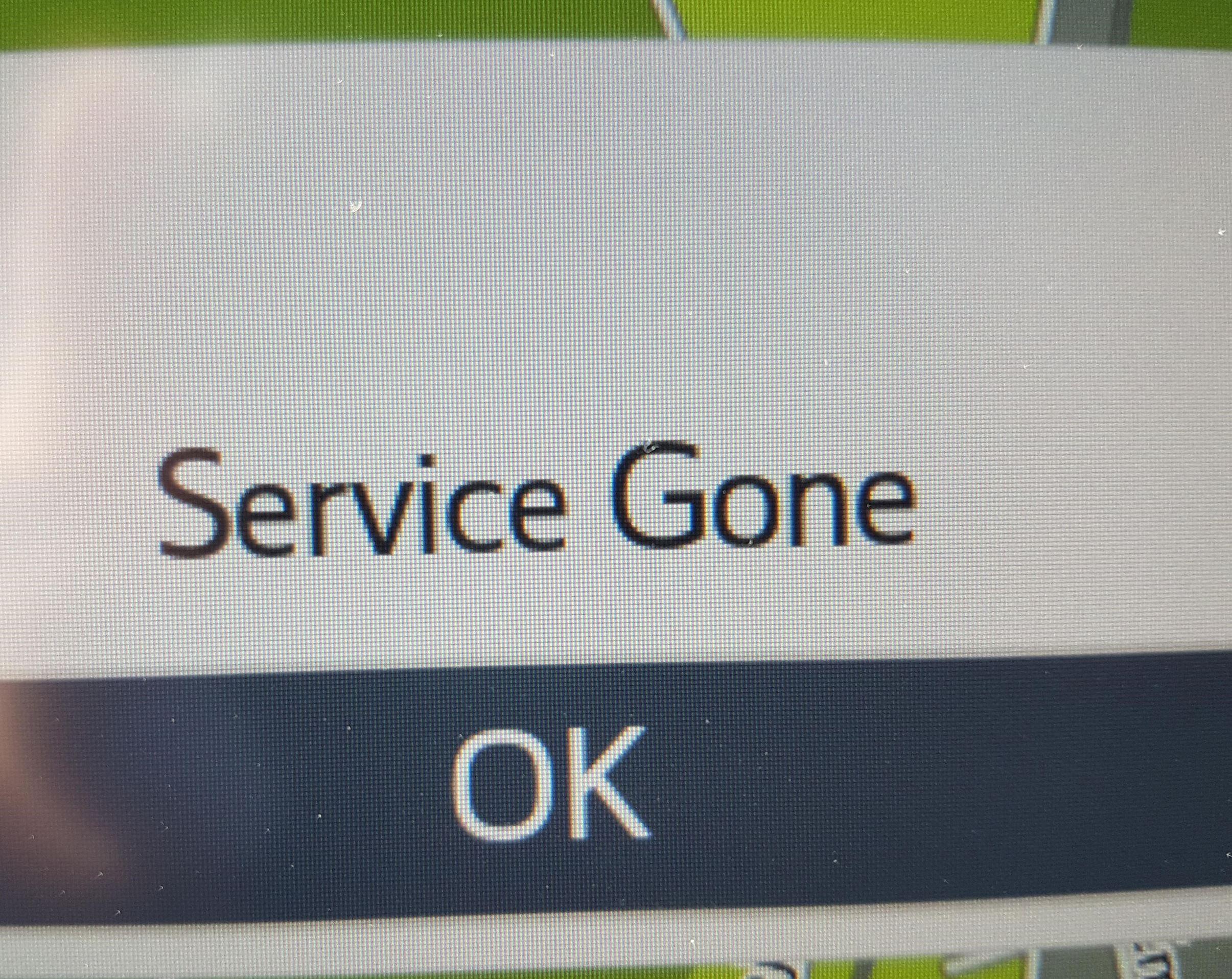

Recently got the same message on my 2019 corolla
Was serviced at 9800 miles 3 months ago and now has less than 18000 miles on the clock
Does this mean the dealer hasn't reset the service counter and will it not go off til completed
I also got this message and my car is only a few months old. I’m guessing it’s nothing to do with car servicing
I wonder if its a general message to toyota owners from toyota to let them know the franchise are closed for servicing
Could "Service" be referring to GPS/back end data services from Toyota as opposed to literal servicing? Seems to be on too many cars for it to be a missed reset surely?
P.S I do not have the message.
Yes, I'm getting it on the Main display, just click OK, and it goes. Likewise, internet service seems connected. I doubt it is anything to do with Hybrid system service. I still have 2,000 miles to go.
Looks to me like it's referring to one of the back-end systems. Us programmers refer to such things as 'services' and that looks like a crude error message for something like My T, or Traffic information going AWOL.
I just replicated the problem in my driveway. The car connected to my land line broadband OK, and the phone was also connected to the car for mobile signal OK. The problem has happened when out and about as well, so not linked to the home Wi Fi.
I checked the emergency system was connected, and the green light was showing, so I assume the emergency assist feature is OK.Today, Data seemed to be transmitting to MyT OK.
So, I cannot see what is not happening, or why we are suddenly getting this message.

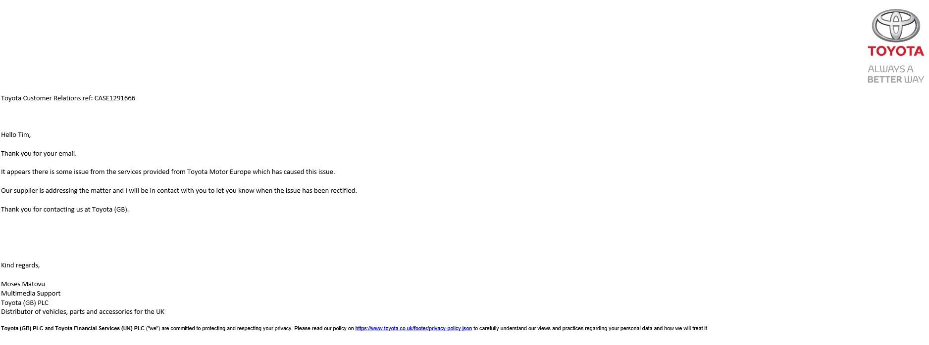

I sent an enquiry to Toyota GB, and the following is their response:
"I have had a response from our technical team in relation to your query surrounding the "Service Gone" message which is being displayed. This is a known issue which relates to a remote server which is temporarily down. This effects the traffic alert function which is displayed on the satellite-navigation in the car. Toyota are currently working on getting the server back up, however please be aware that due to the global Covid-19 pandemic, there may be a delay in resolving this issue."

I also had this email back this morning. Your contact gave much more info. I guess at the moment, traffic alerts not being available will not be a disaster.
Thanks, Frostyballs and Timmon, problem if not exactly solved then at least illuminated!
