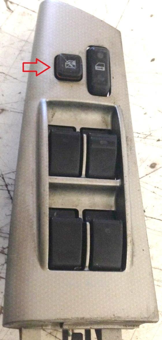

Have you accidentally pressed the window isolation switch on the driver's door switch panel - which stops the non-driver's windows operating??
Hi Frosty, I didn't know about that switch. Is it located by the other switches on drivers door panel?
I think Frosty is talking about this one :-
Yes - as I said it is on the driver's door switch panel as above. Common error to depress the switch without noticing.
Thank you guys, that was the problem. I am pleased you posted before I spent ages going though the  fuses.
