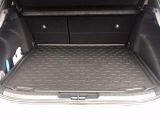

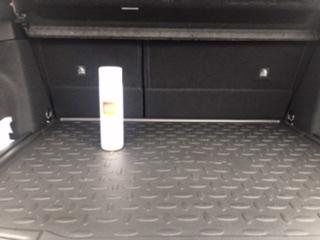

ok it’s 60 cm from the floor to the top edge of the hatch opening.

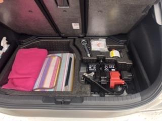

My 1.8 hybrid came with a spare wheel. The loss of luggage space is considerable!
My 1.8 also came with a spare wheel option.  It is a space saver but room enough for the punctured wheel.
Yes, there is a significant loss of space as the floor is now flush with the folded seats.  If we get another 1.8 Corolla I would go for the high floor again despite the reduced space.  We find the flat load area with seats folded much more convenient.
