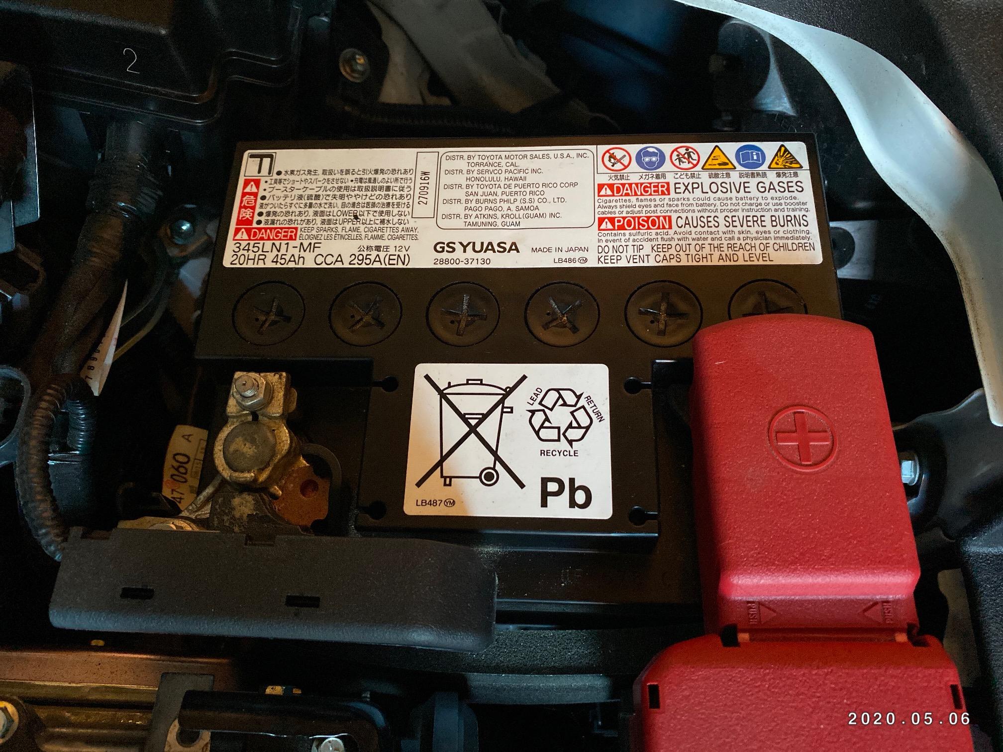

I have purchased a Smart charger too which I am pleased with as I am currently not using my car due to the lockdown.  One thing I cannot find any info on is whether the Battery is sealed or able to be topped up.
My Battery is probably like most people's which has caps, but they appear either to be sealed or are very tough to open, but I notice they do have what looks like small vent holes.  I didn't want to risk undoing them if they are not supposed to be opened.  I just thought it would be a good idea to check the level if it was possible.  My car was only serviced in March, but looking through the paperwork it seems that only a visual check is done.
The caps will open but are very tight. You can use a 2pence piece with the help of a pair of pliers.

Great, thank you 👍
