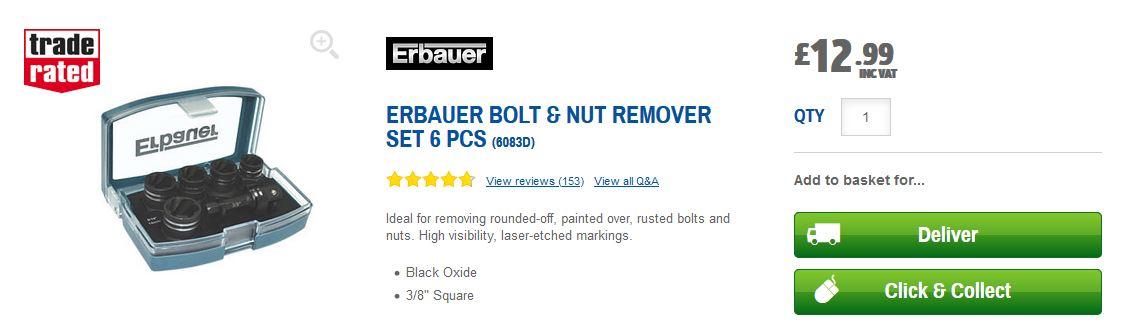

To release the rounded caliper bolt think it was one of these  kits we used, but do check the sizes !  replacement bolts were purchased cheaply from the  local Toyota dealer as they are a high tensile type, but do not know their parameters.

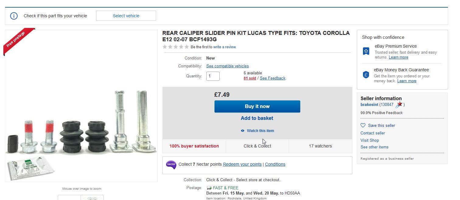

If you cannot get anything from Toyota, this place hs a good selection of replacement parts, we use them  https://www.brakesint.co.uk/shop.html
Got the 2 caliper bolts out with a Irwin bolt removal socket. Nothing would get the bottom front carrier bolt to shift, ended up cutting the head off and withdrawing the carrier with the disk.

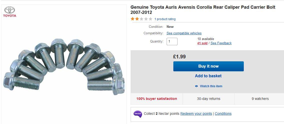

Had a look on eBay and they appear to be £16 for 2 bolts or £18.50 for the sliders as well.
from a guy who is used to buying bits for an old land rover this seem s a bit exessive. As will need 2 sets of these and still havent found any carrier bolts
The Caliper bolts are about £2 each , Toyota eBay online show them for the 2007 on models, worth checking if they are actually sending parts out.
They only seem to list parts they have sent out, so you need  to email them  for a quote for your model. reg no and Vin etc
That Brakes International direct site seems to be stuck, but again their eBay store does list their kits, but as they say, your need to look on the calipers to see what make they are, normally Aisin or Lucas/TWR.
Expect the TS brakes are a bit different from the standard models ?
