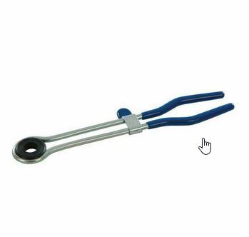

Use a pair of vice grips and lock them tight enough to hold back the fluid but not too tight as it could damage the hose.
Have used these for many years, about £3
