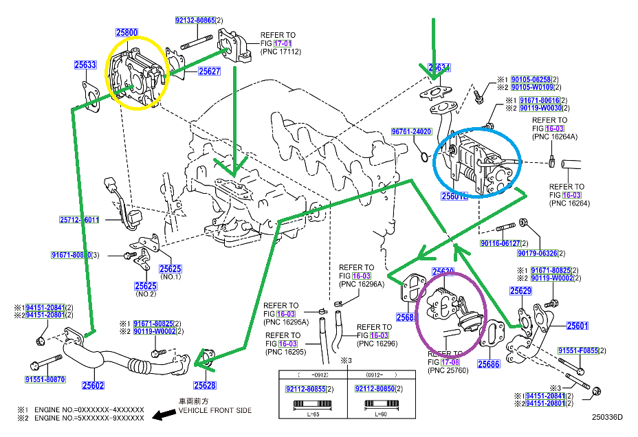

So what have you done about it, removed , cleaned, tested,diagnosed?
The engine ECU is detecting insufficient air flow through the EGR system attached is a pic of the EGR routing:
Green is the route of the exhaust gas from the exhaust through EGR Cooler onto the first EGR Valve then through the side if the cylinder head and onto the main EGR valve before entering the intake manifold there could be a blockage of carbon or either of the valves could be stuck/sticking shut.
There aren't any EGR blanking plates fitted?
No egr plate fitted take it to dealer now next to put it up on computer  and get decision then an what next step
