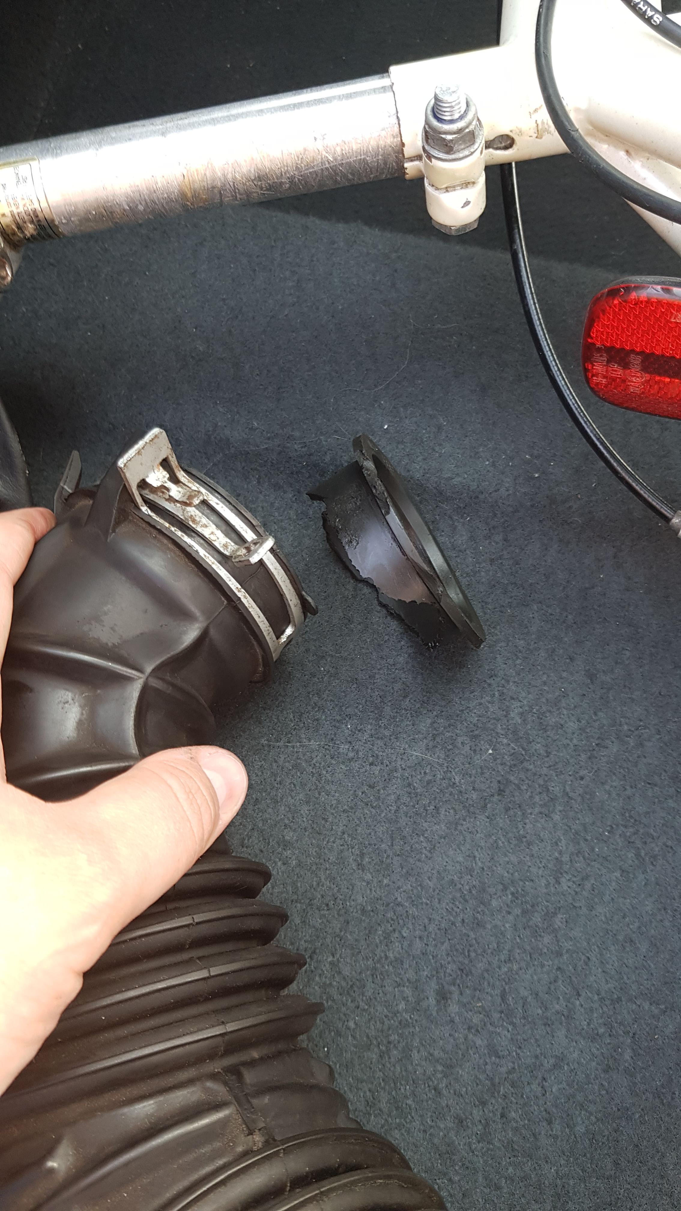

Roadrunner1986 1 Posted June 25, 2020 Author Share Posted June 25, 2020 Morning all. Well I went out to have a look at the egr. Popped the bonnet, noticed the intake hose was loose. Anyway I took it off to find this in the turbo pipe leading to impeller. I'm hoping this is the route of my problems but who can say. Quote Link to post Share on other sites
Tomm5 5 Posted June 25, 2020 Share Posted June 25, 2020 That's weird one never came across rotten turbo pipe like that before Quote Link to post Share on other sites
Roadrunner1986 1 Posted June 25, 2020 Author Share Posted June 25, 2020 It wasn't rotten. It sucked the rubber seal in chewed it up in the impeller and bent the vanes. 😔 Quote Link to post Share on other sites
