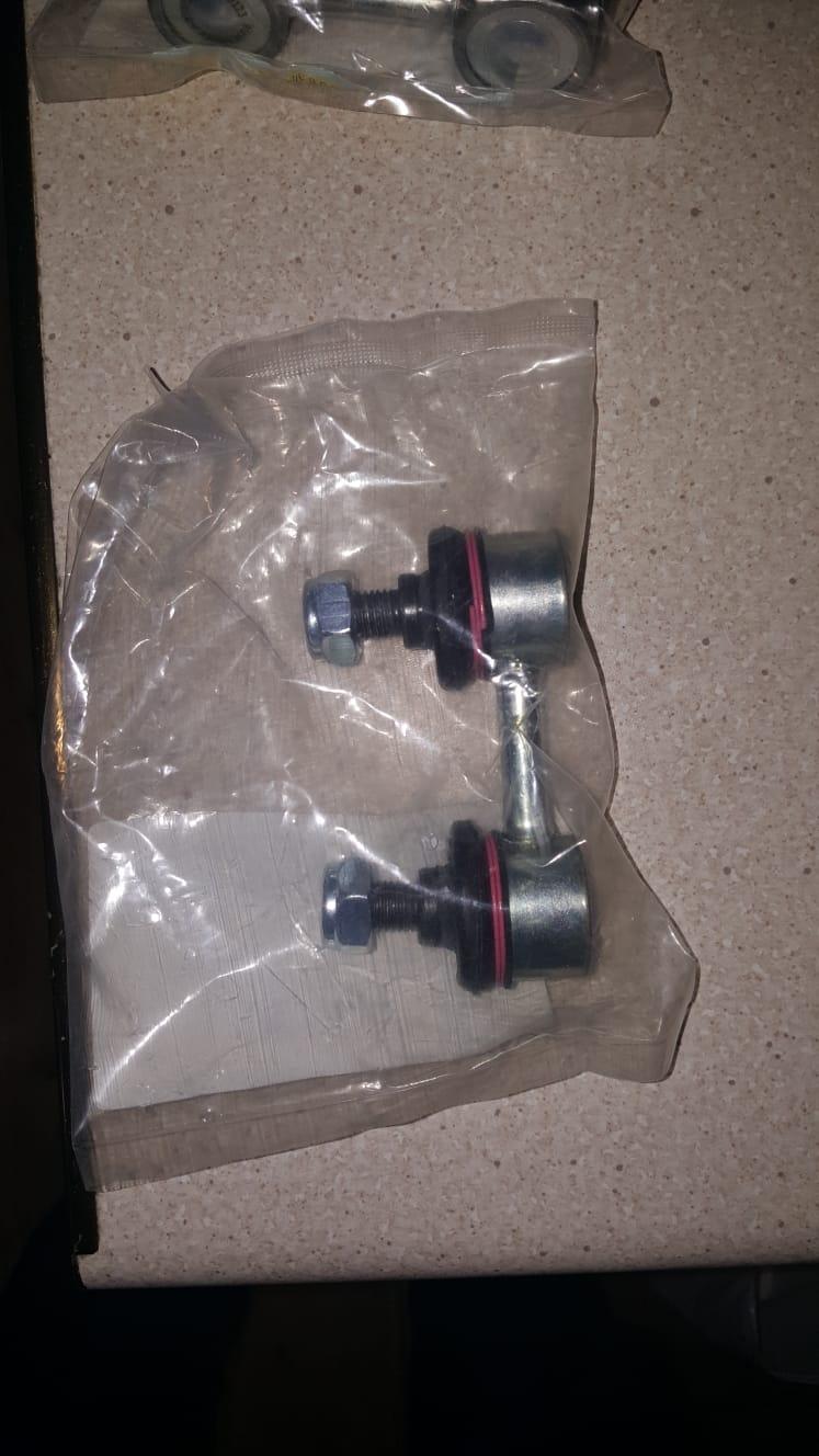

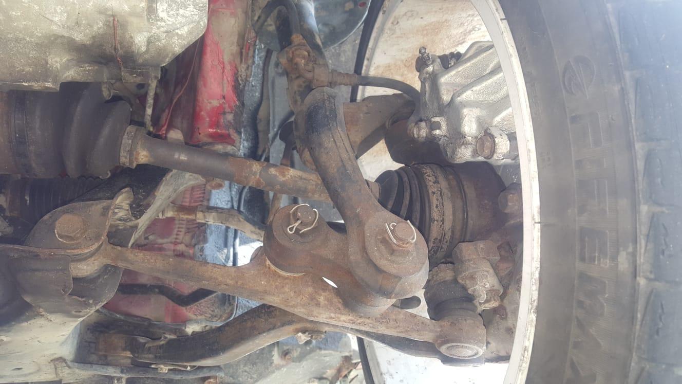

I'm planning on changing my drop links this weekend, its ST202 non superstrut. My local motor parts supplier gave me these drop links which are a lot shorter than the ones currently fitted. Could this be the reason for the knocking from the front end or did he give me the wrong ones?

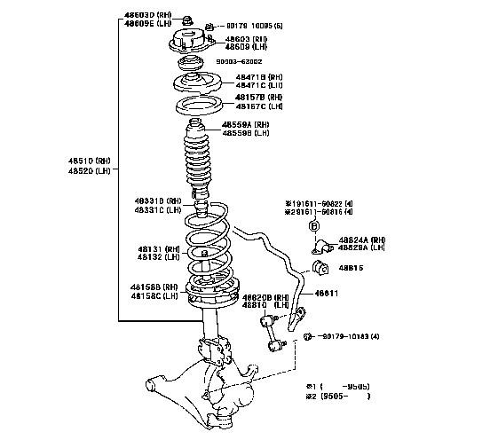

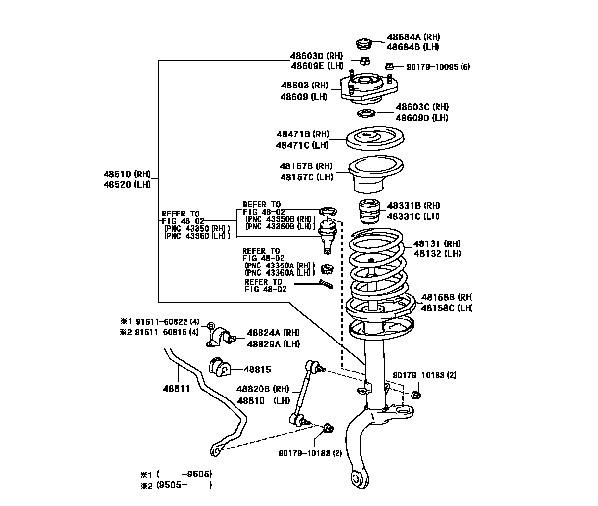

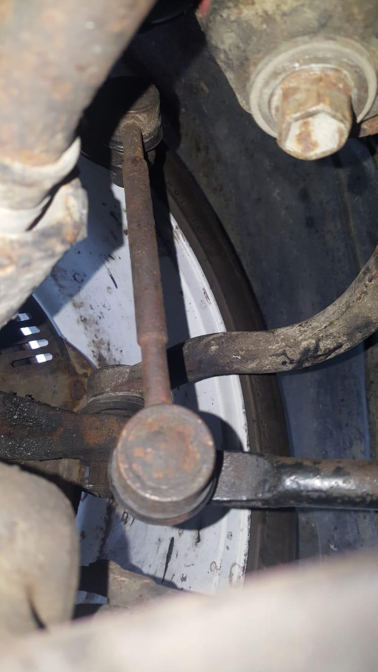

You have super struts !! The links you have been supplied are standard items
Toyota part numbers are
48820-33010 60mm (Febi 18107)
or
48820-20060 (super strut) 165mm (Febi 42949)
PM me your vin and i will confirm it
