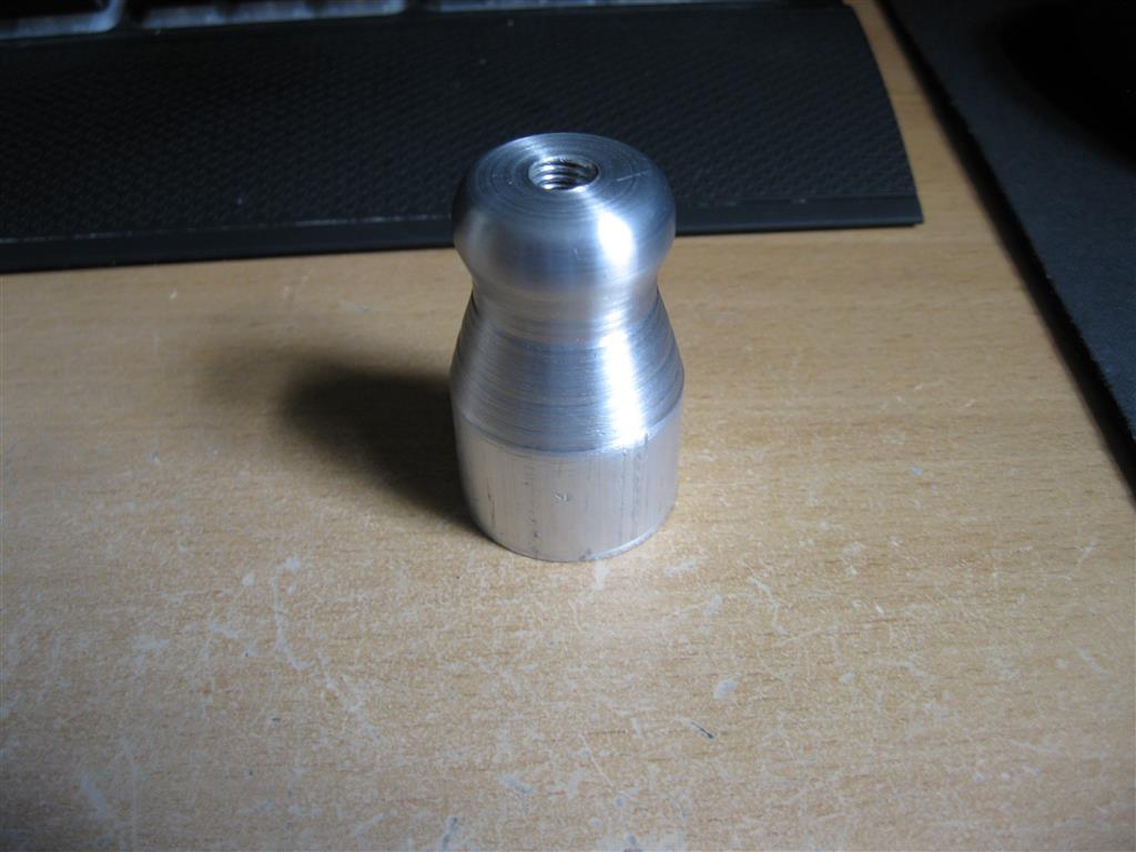

I needed something to do so i machined up a new selector knob from a bit of bar stock i had knocking about, faced off, centre drilled, drilled out to 6.8mm and tapped a M8 x 1.25 thread - roughed to shape - made and adapter to hold it in the chuck, turned to final shape

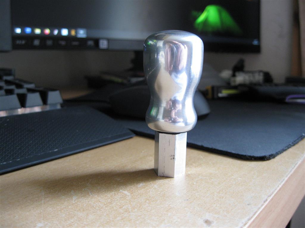

Linished to a part finish, then polished but i still want to repolish it with a finer compound - the diameter may be on the small side so i may make another one
