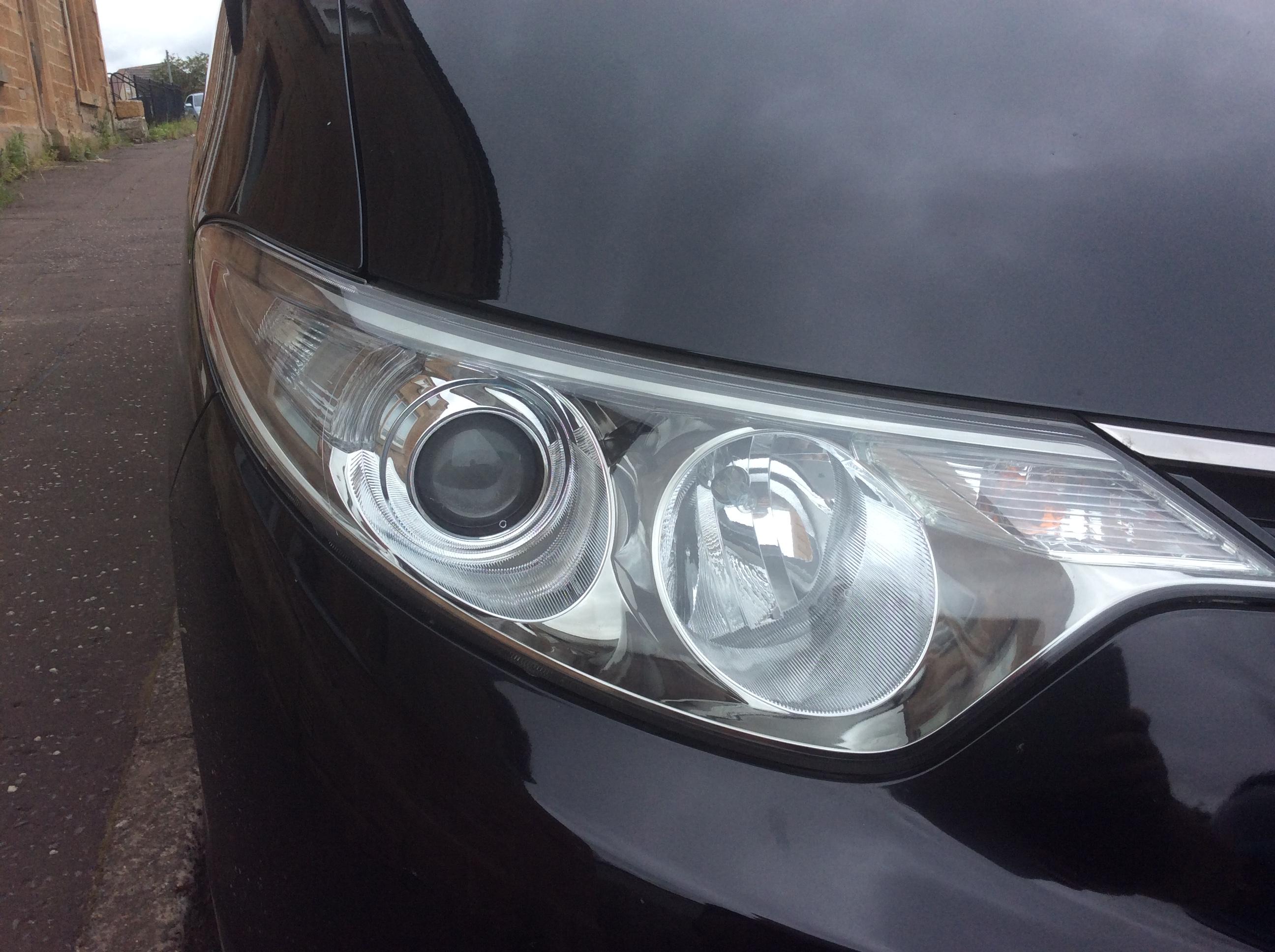

The two main lights , when on dipped beam is it the one on the left that is on and the one on the right off .and the one on the right is full beam only
and when switched to auto lights should come on automatic when getting dark , basically is this right as the dipped beam light is not that bright
Edited by Celt
On Estima “light “ with the lens is dipped beam , without lens is full beam. When you want to turn on full beam , dipped beam stays on also.
when you turn “auto” lights, lights will come on automatically, but first will turns on is side lights, when it gets more darker dipped will comes on.
if your dipped beam isn’t bright I would suggest that you need to change/replace bulbs. it’s not so straight forward , but can be done. I replaced bulbs on mine about a year ago. bulbs cost me 104£ Osram night breaker. Got the from eurocarparts. Have tried to replace them how manuals recommend, but after short while gave up and took off bumper.
