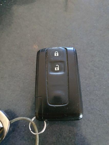

A pic of the fob would help, there should be a code on it eg. B23TA, I'm sure the smart remote is B75EA (89904-0F010)

photo of the fob is attached.  thanks.
It's a B23TA 89070-0F022 or 89070-0F021
feel free to double check that number
