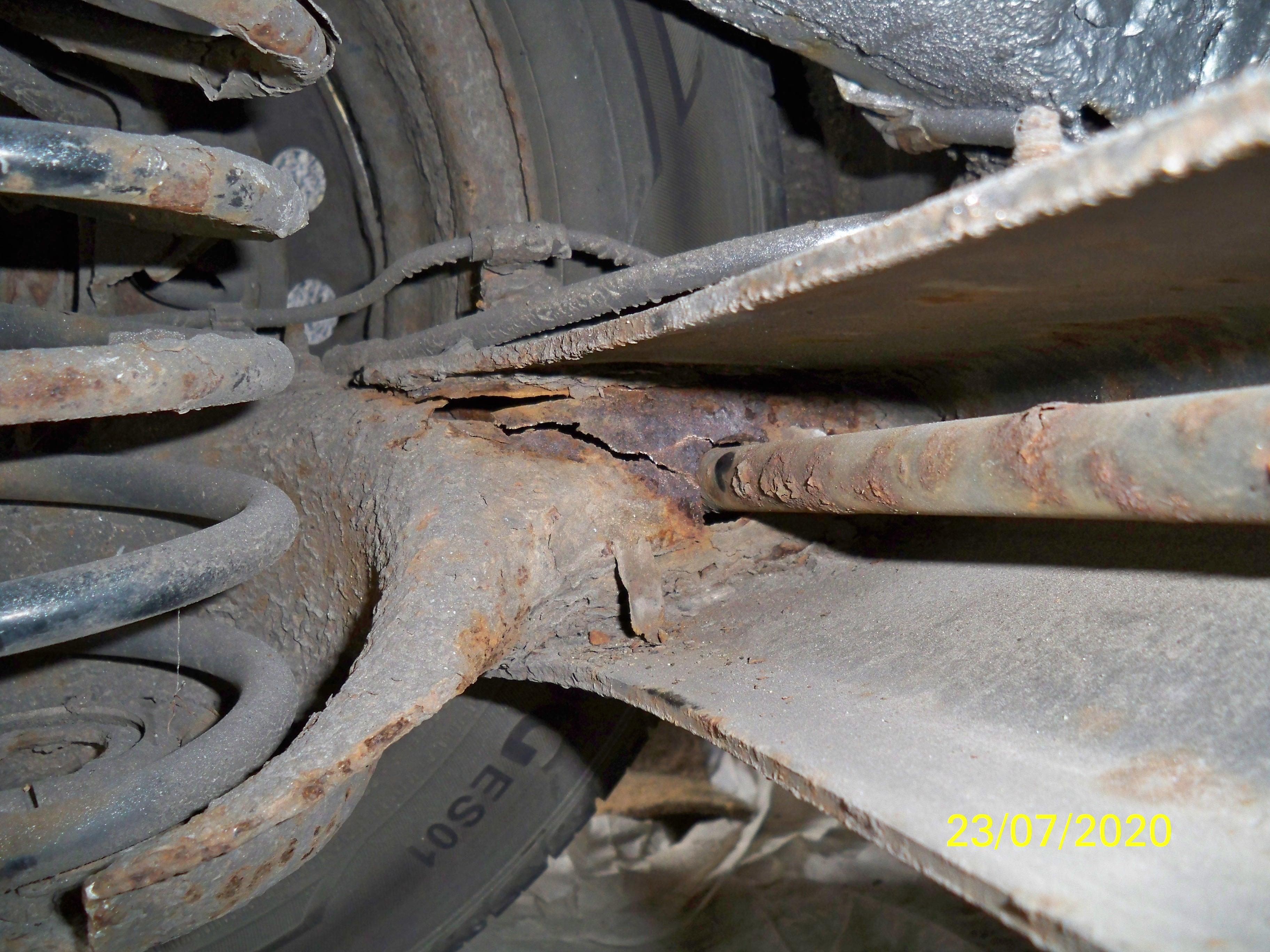

Driving back from town (less than a mile) I started to notice a knock as I went round corners.
This eventually became a constant rubbing. So I put the hazards on and limped home.
When I got home I discovered the rear wheel had an "intersting" camber to it and was rubbing on the strut. Imediately I thought the cheap(ish) hub assembly that one MOT centre said had play in it had given out after 2 years.
NOT SO!!
The the arm that comes from the rear beam to the wheel has rusted to the point that it has cracked through and twisted.
Now I'm shocked as it had an MOT in Feb and had some sil rust done, but nothing mentioned about the rear beam!
Now I find out that the beam is different on models across a single phase and depending where it was made. Do toyota just send a picture of a car to the factory and say "make that" instead of parts and drawings. How on earth could this be so?
If you are not doing the work yourself it's time to scrap it tbh the problem is finding another beam that is in good condition

Thanks everyone, the beam itself wasn't hard to get out, but before we completely removed it we set about undoing the brake lines........which all rounded off or sheared the pipe despite a very liberal application of PlusGas.
We also found another big crusty patch that was breaking through right at the passenger side beam mounting point.
I've got to say the under floor design at the back end is shocking.
So many catch point for dirt to impact. So many little pockets to hold moisture. Just terrible design back there.
So my "reliable" Yaris get to be the first car I have EVER had to scrap.
I am so disheartened
R.I.P  Yannis
