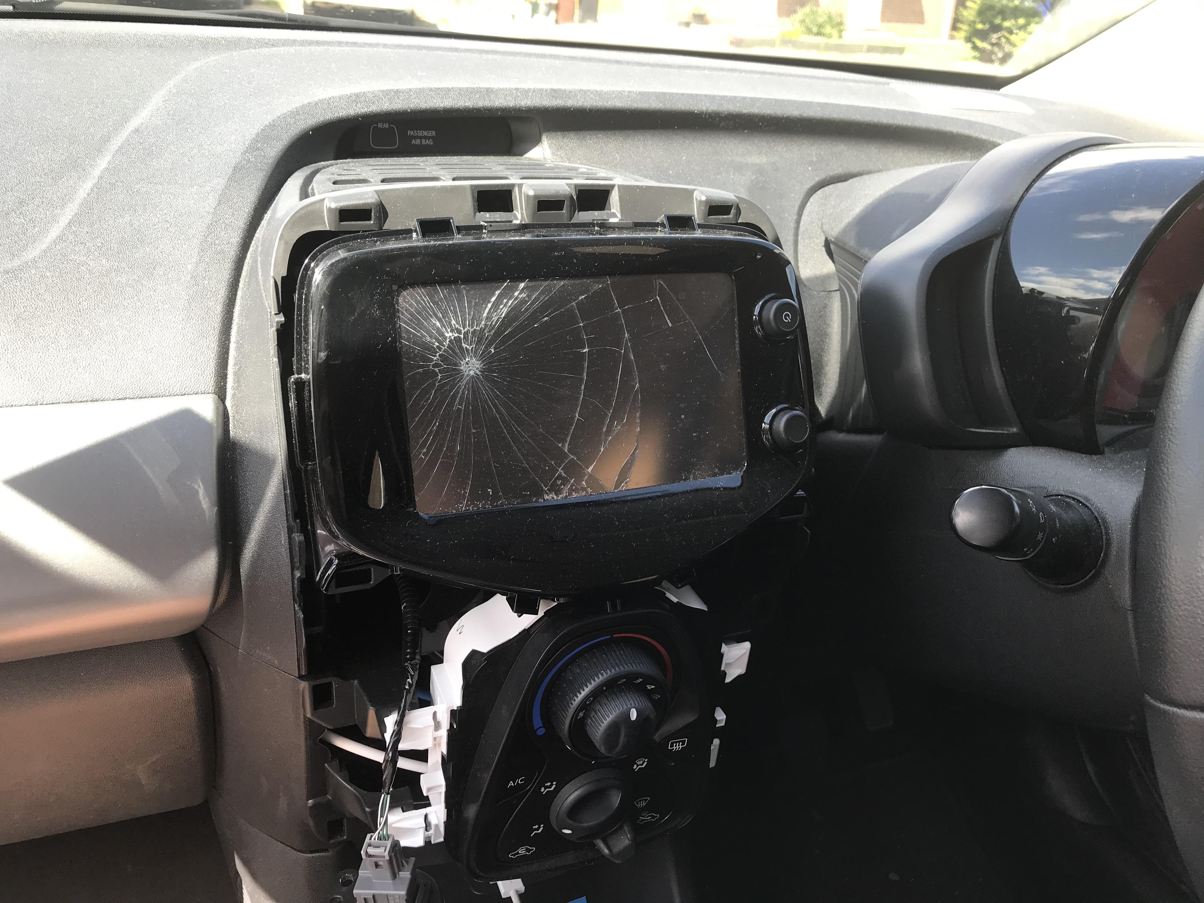

I have a 2019 Aygo and after an accidental item throwing incident the touchscreen on my stereo was smashed!
I’ve bought a replacement on eBay and swapped it over but noticed it had a different model number. Anyone know the difference between 861400H071 (The one I took out) and 861400H020 (the replacement I put in)?

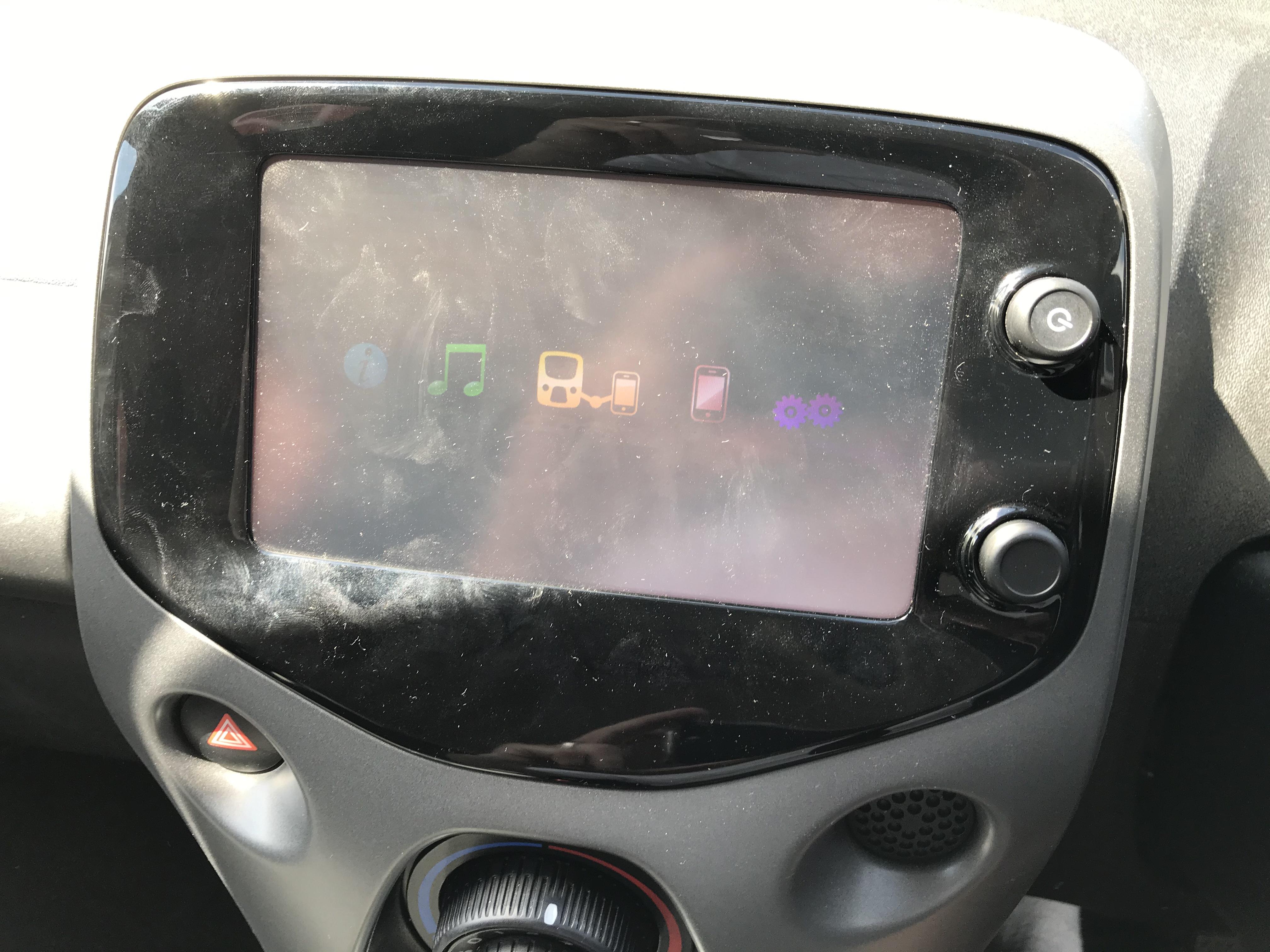

Not really sure what the Apple/android things are if it did have them I never used them! Here are pictures of both. The replacement seems to be working fine, connects to my phone picks up all stereo signals so I’m not really worried about the difference just curious 😀
I think the replacement came of a Peugeot 108 if that might explain it?
