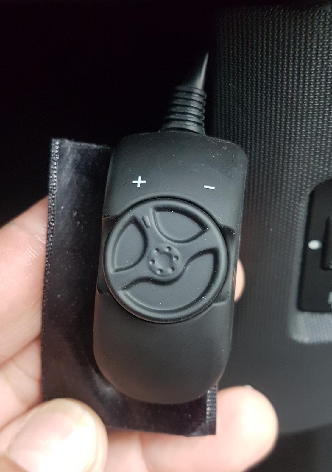

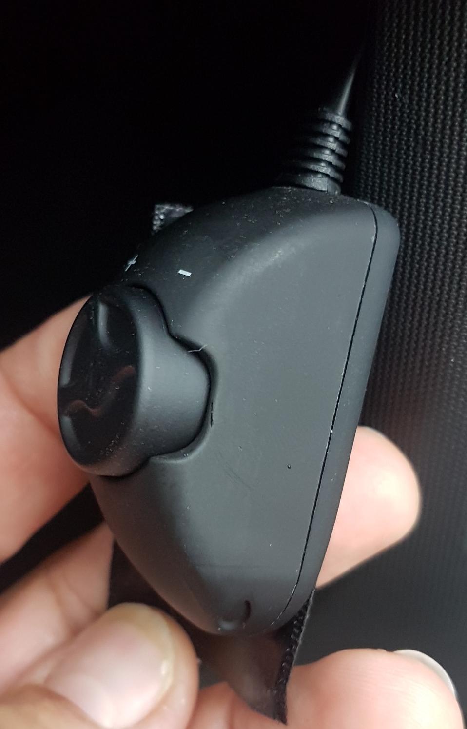

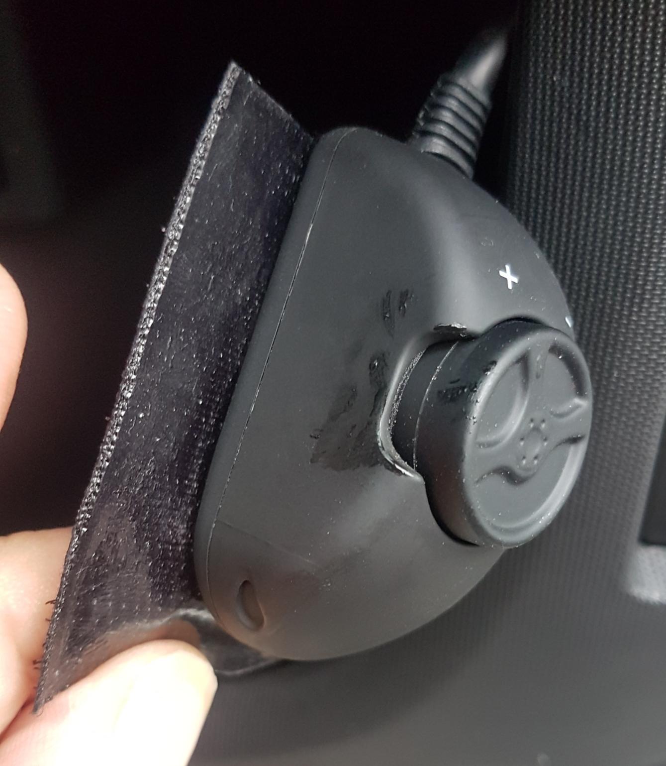

Hi all, finally bought my second car Aygo yesterday and not sure what this is (pictures attached) its velcrowed near the light level switch! Abit strange this!!  its cable attached but to what? If anyone who knows would be apreciated!.
Cheers
J

find the wires and track where they go to or take to a toyota dealer see what they think
Sent from my RCT6613W23PU using Tapatalk
At a guess it adjusts the power steering  - dealership will not have a clue or give a T0ss on a 10 year old car
But where would it work it's a hydraulic powersteering?
Sent from my G8341 using Tapatalk
Didn't the Aygo have eps from launch ?

Hi thanks for your reply, interesting regards to the EPS (electric Power Steering)? My car is a 2012... ill search that up and see what comes up.... thanks for your input guys, your all great.

I recon this one looks like a subwoofer thingy, control knob, to adjust the bass?
Hmmm
Does look like it but cant imagine an elderly woman turning up bass whilst driving down the street lol, i tried looking but cant find anything on the net, too much rain to start taking panels off, when rain stops im gonna have to trace where the cable runs to..

Aygo has electric power steering. Reckon it's what Bob says, to adjust power steering assistance. Think small Fiats have the same thing. A parking switch which lightens up the steering somewhat.

On all Aygos which have power steering it's 100% electric (there's an electric motor attached to the steering column).
BTW in some countries (not the UK) Aygos were sold without power steering.
if its eps related turn it up will lighten the steering, turn it down will make it heavy, I have seen this sort of thing before added as a drivers aid
Bass control did cross my mind, but they usually have 2 knobs plus the knob in the OP's picture has an embossed steering wheel on it
