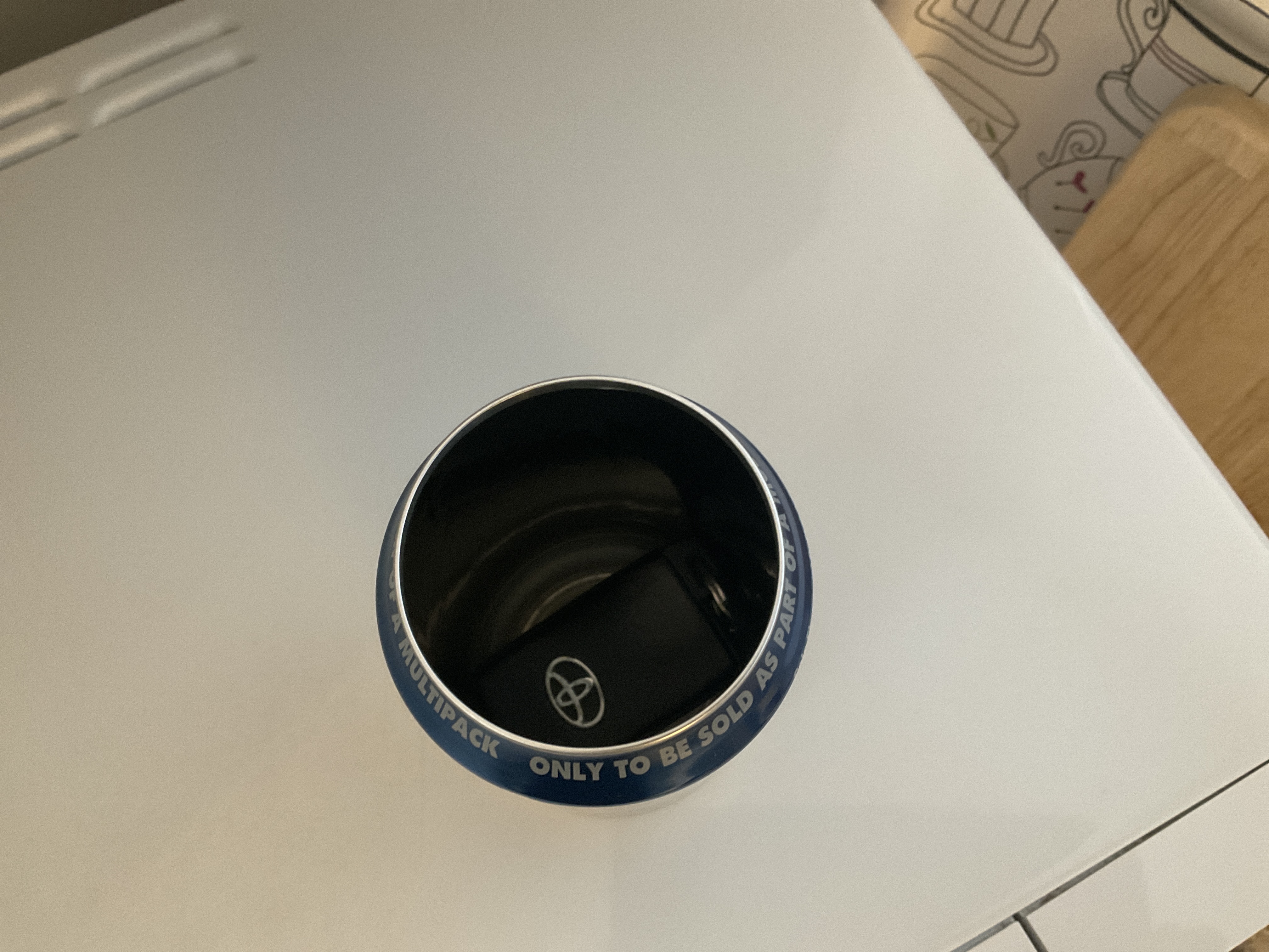

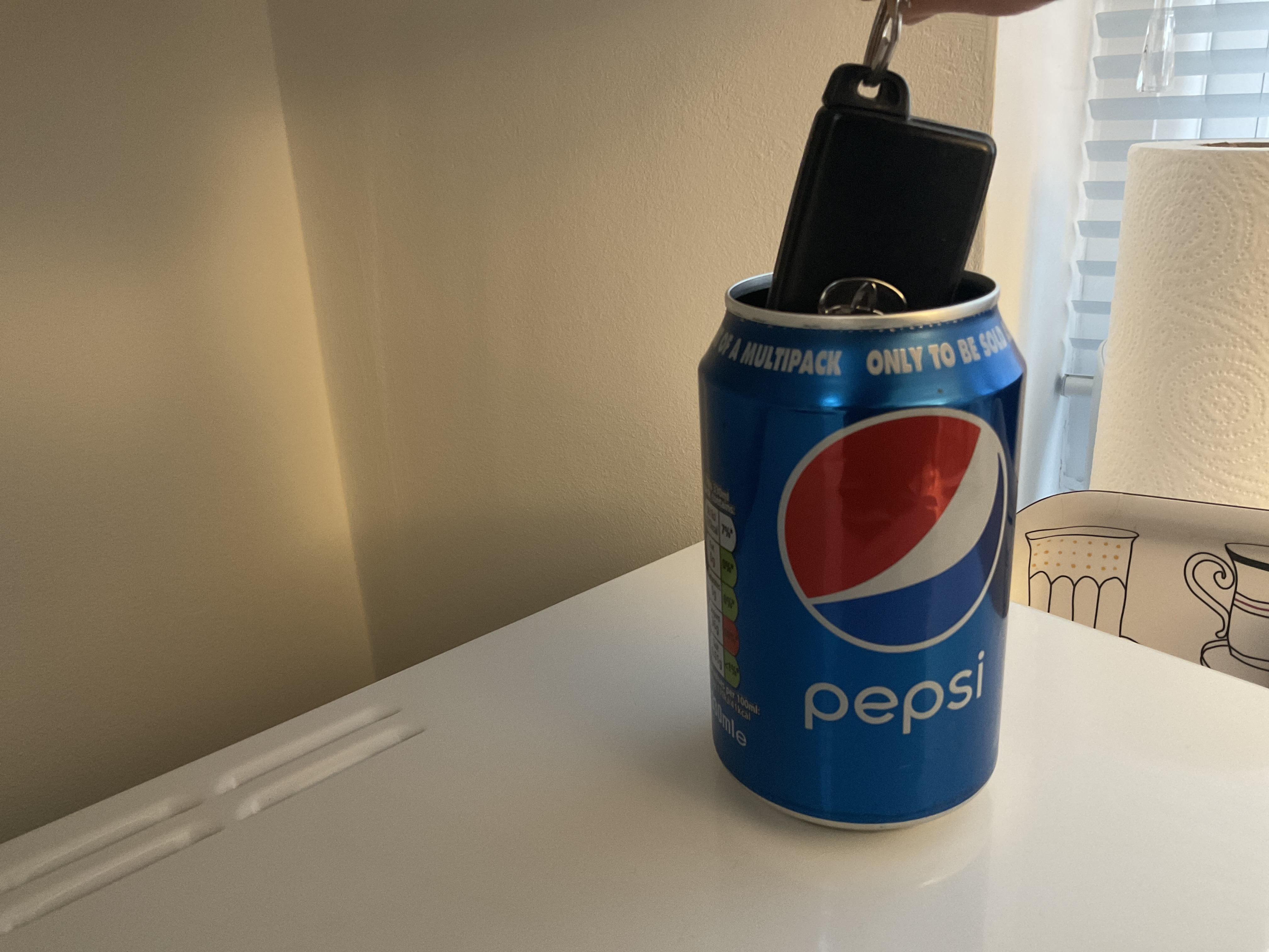

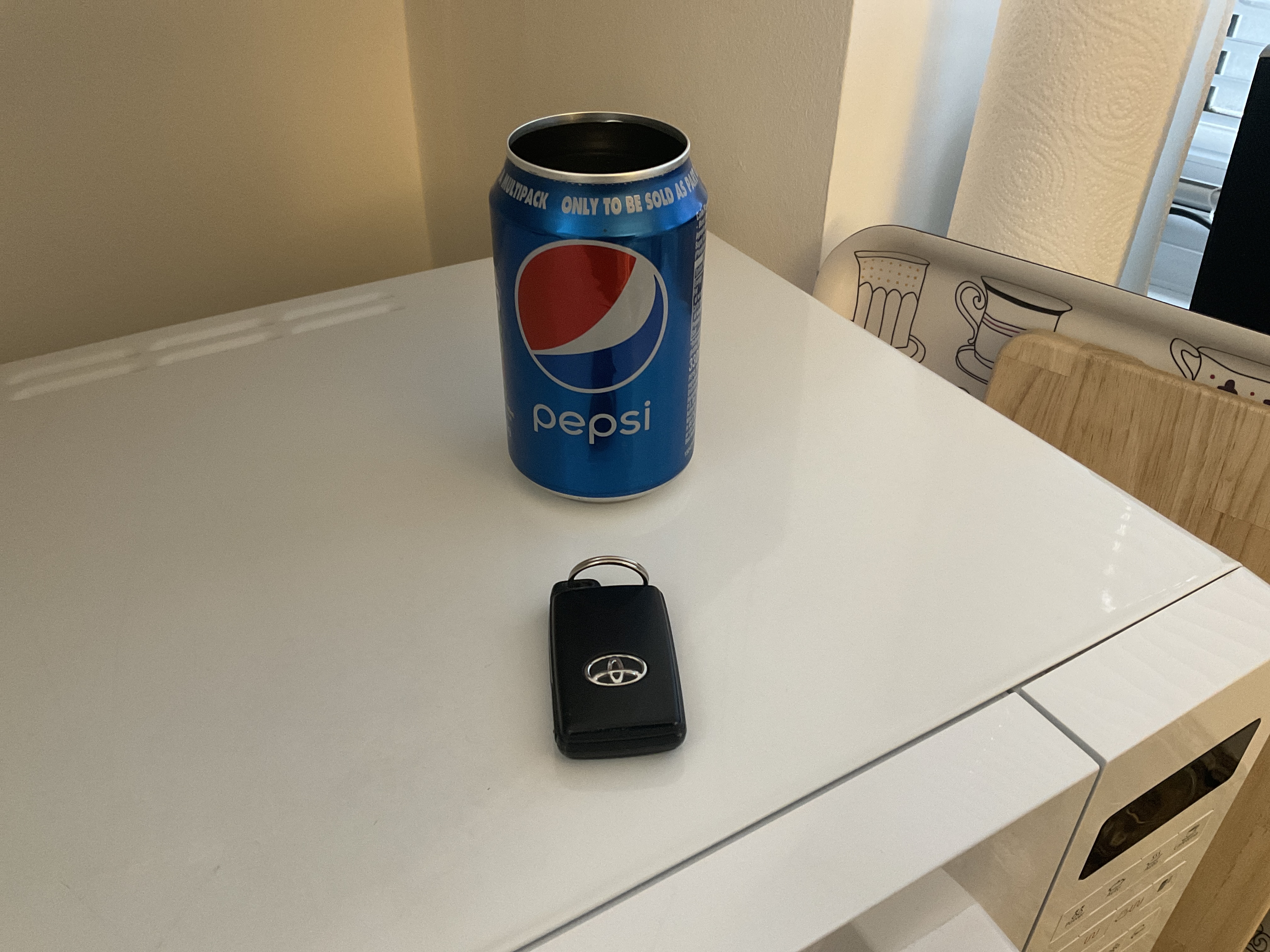

When inside the car and hold the key, car on ready mode , put the key in the can or biscuits box and see if you get a message on display “key not detected “, just to make sure works. 👍
Tony, thank you.  I tried a range check.  My garage is attached to the house.  My keys are near my front door and on a direct line about 20 feet away.  On a diagonal the direct path passes through a double thermalite block wall.  The key works.  Rather than your pepsi can idea I think we can go one better.  We have a small drawer in our hall table.  It is the exact size of a Marks and Spencer Belgian chocolate biscuit tin*.  I will try that.
*I must declare an interest, we have M&S shares so please try their biscuit tin 🙂
A peripheral tips, flat key Battery,  Open car with emergency key, hold keyfob up to Start button, press start.
