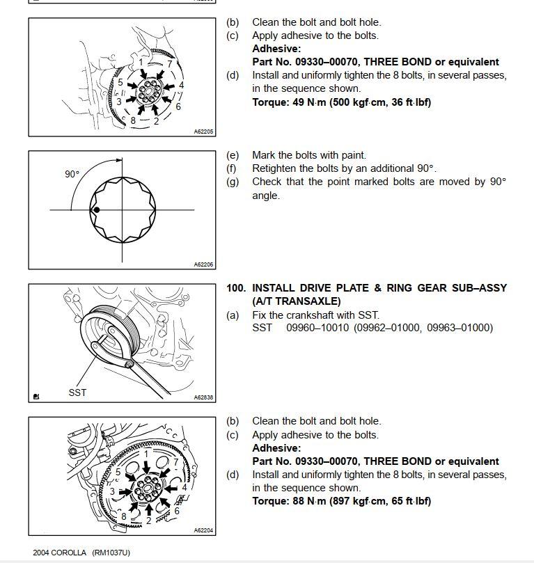

oldcodger 342 Posted November 20, 2020 Share Posted November 20, 2020 Seems an often asked question about the bolts, but no clear answer in the info I have. As you can see there is a very exact sequence to refitting the bolts on standard 1.4 /1.6 so would think the higher powered TS its more important. Think you need to get the details from Toyotas info sheets. Why are you replacing the flywheel ? new clutch, could it not be skimmed for a few £. Again for such an engine, is "the cheapest" the best way ? PIc 1.4 / 1.6 manual specs Quote Link to post Share on other sites
flash22 656 Posted November 20, 2020 Share Posted November 20, 2020 2zz ? If they are stretch bolts, yes they need changing If not blue Loctite and torque to spec edit. Arp flywheel bolts are around £45 a set - drop https://www.competitionsupplies.com/ an email or give them a call 1 Quote Link to post Share on other sites
Parts-King 761 Posted November 20, 2020 Share Posted November 20, 2020 The bolts need replacing, and if you buy a genuine flywheel, you will also need the 3 dowels as they don't come on the flywheel 👍 Quote Link to post Share on other sites
flash22 656 Posted November 20, 2020 Share Posted November 20, 2020 I was just about to post they are stretch bolts aka torque to yeld They are M10 x 1.25 - 22mm long ( 0.875˝ ) ARP 103-2802 Quote Link to post Share on other sites
