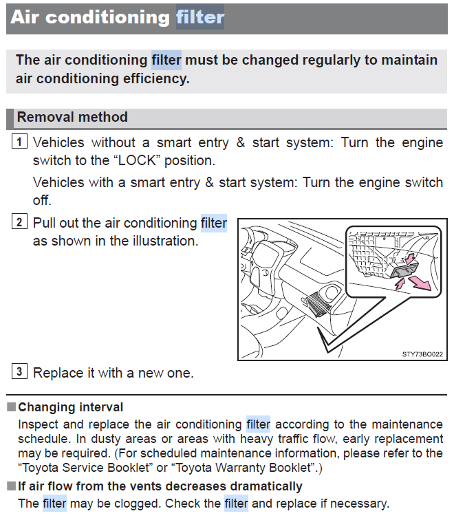

Rockfish 1 Posted December 21, 2020 Share Posted December 21, 2020 Hi anyone know where the pollen filter is located on the mk.2 Aygo & whether it is easy to change?Thanks. ? Quote Link to post Share on other sites
PetrolDave 25 Posted December 21, 2020 Share Posted December 21, 2020 57 minutes ago, Rockfish said: Hi anyone know where the pollen filter is located on the mk.2 Aygo & whether it is easy to change?Thanks. ? Hope this helps: Quote Link to post Share on other sites
Rockfish 1 Posted December 23, 2020 Author Share Posted December 23, 2020 Thanks for that Dave,will have a go if it ever stops raining! 1 Quote Link to post Share on other sites
Rockfish 1 Posted January 6 Author Share Posted January 6 FOUND IT! Thanks for the help. Quote Link to post Share on other sites
