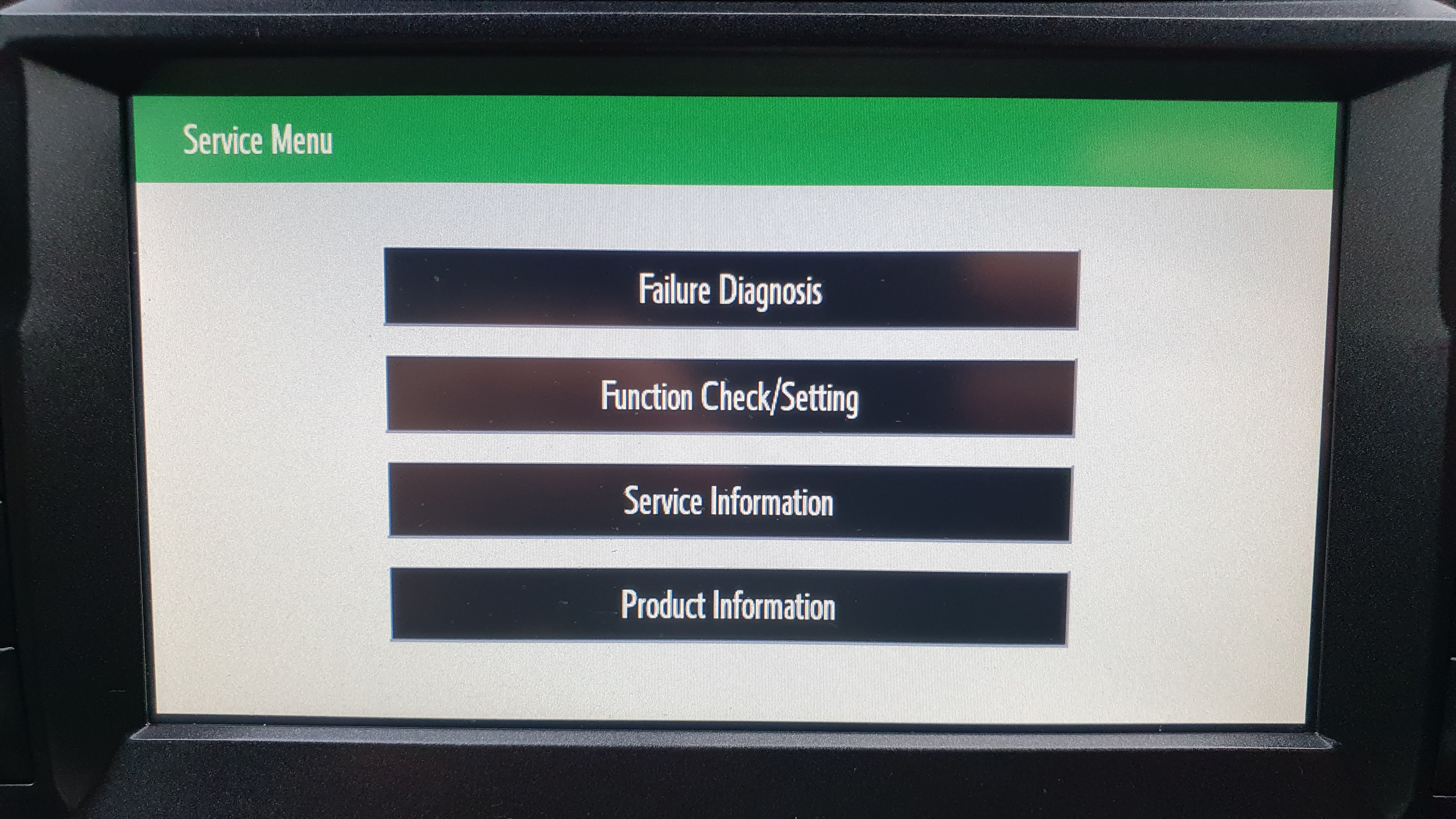

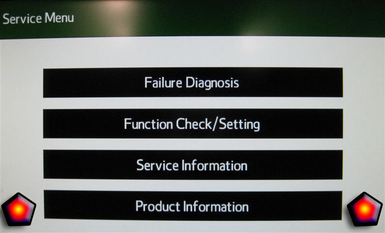

2nd hidden menu
Press the bottom corner left (1) and right (2) 3 times each alternating between left and right e.g. 1 -2, 1-2, 1-2
Thanks

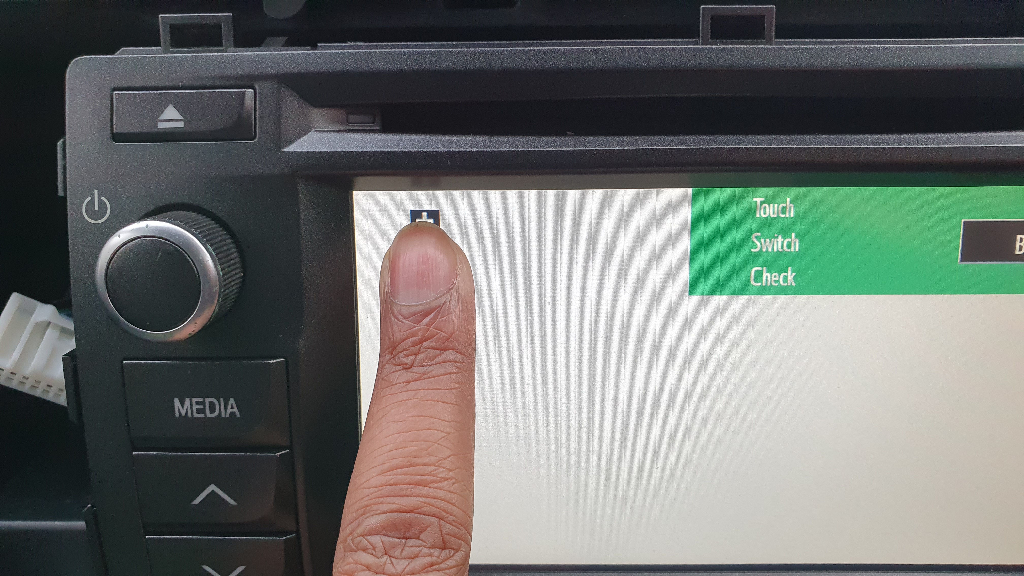

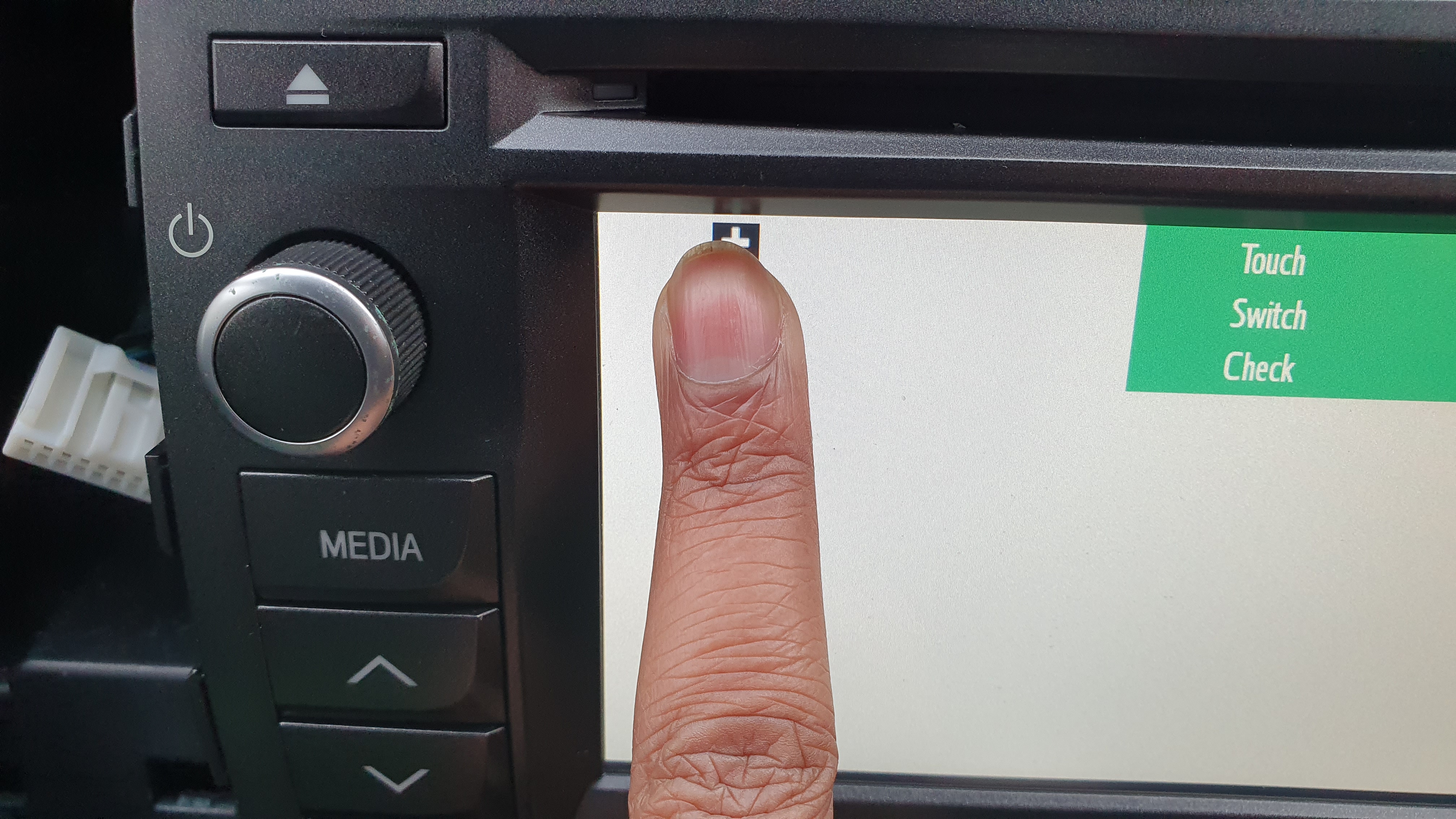

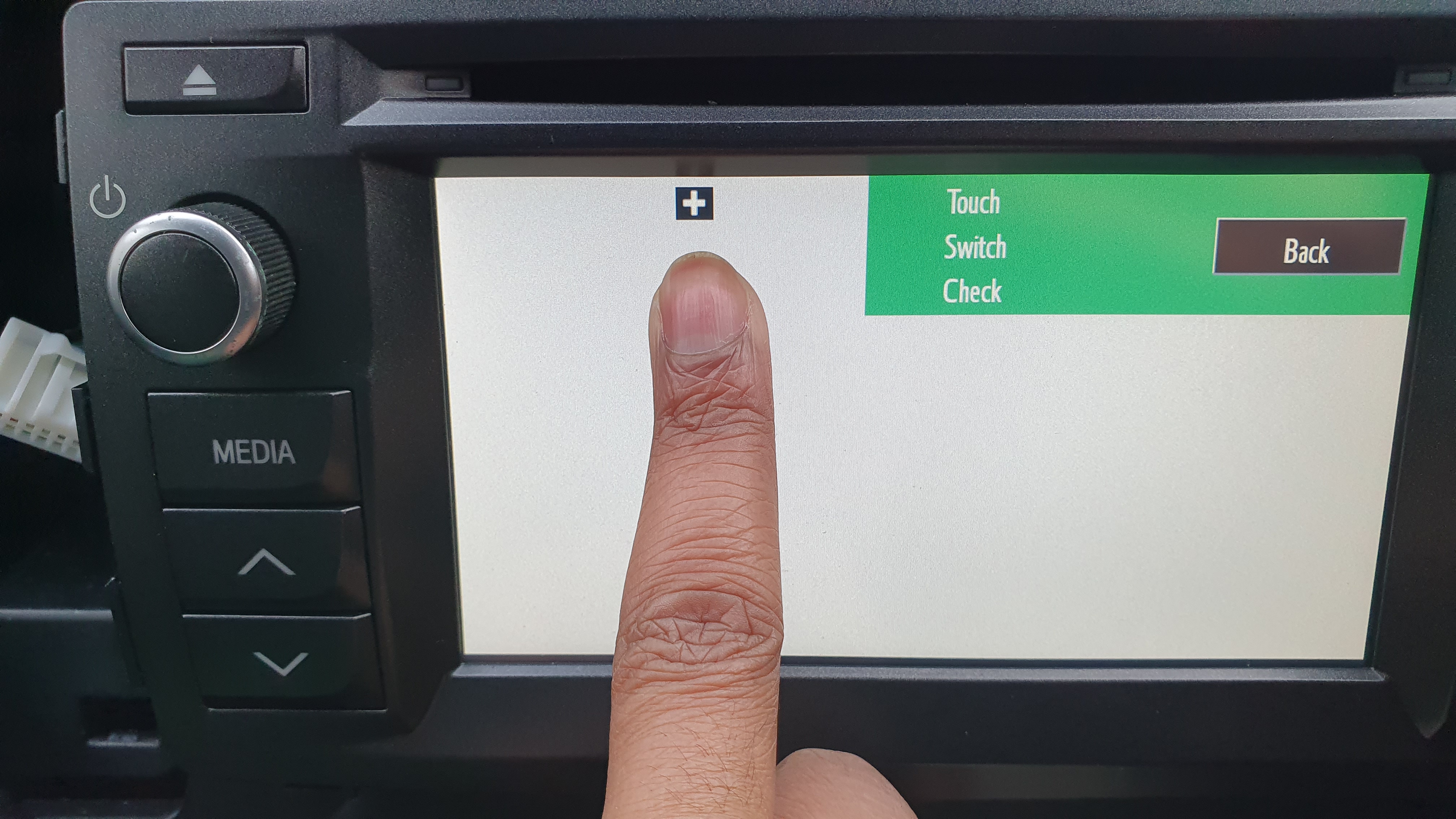

Car or Media button gets me this, cant get to the 2nd menu.
I need to get to the 2nd screen to calibrate my touchscreen as it a bit off on the top half.
20201228_140639.thumb.jpg.19c03b4d1171fa9a84a0cadf76a90872.jpg20201228_140702.thumb.jpg.0d985913cd57544d07b9981cfeacbb76.jpg20201228_140649.thumb.jpg.662b32d2476aa9054a3b403ed7365d51.jpg

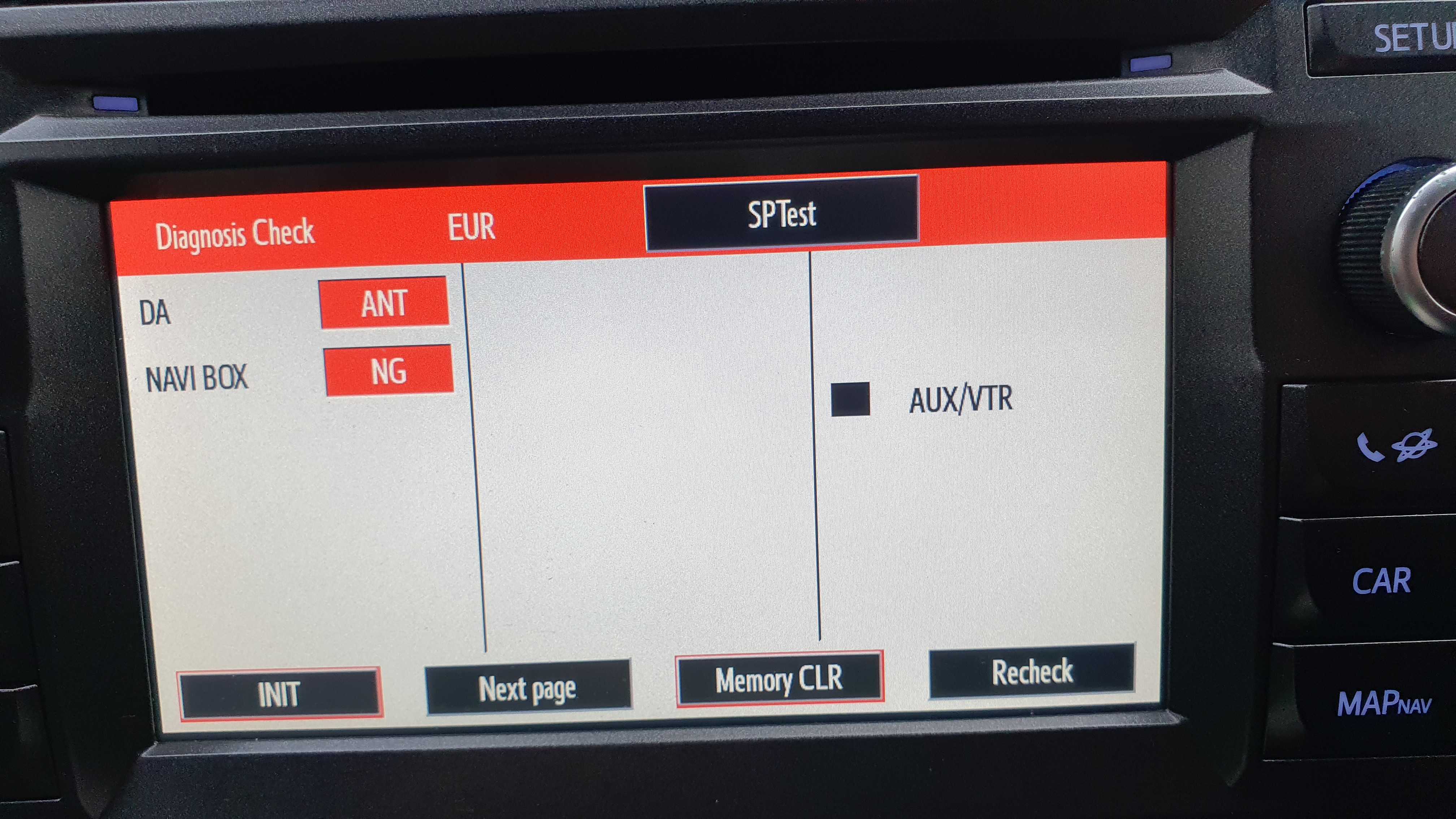

Setup button + light gets me this, it similar to one of the test menus above

What is the calibration like in the lower corners ? Have you tried it with the blunt end of a pen or stylus ?
Lower half is OK, until I touch very close to the lower edge, cross then shows on the top edge.
Same with pen or finger on the top half.

43 minutes ago, flash22 said:
Tap the very upper corners  To get the menu ?
Tried all possible combination, top left top right, bottom left and right, diagonally, top left bottom left and bottom right etc
