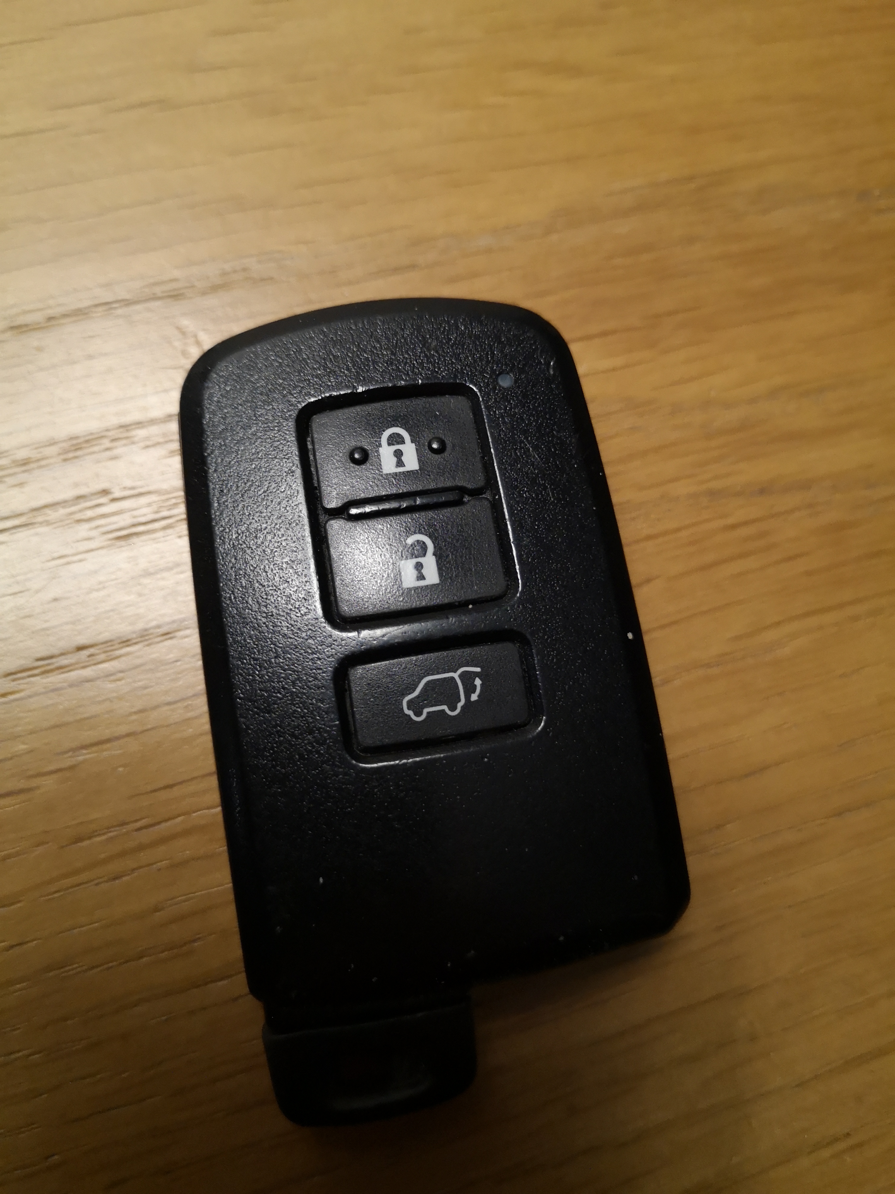

I have a 2017 Rav4 Mk4 Hybrid and one thing that is puzzling me.
It's to do with locking the boot with the wireless fob.
I can unlock and open the power boot with a button on the wireless fob by holding it for approx 1sec. Using the boot button unlocks and opens only the boot. All other doors stay locked.
The problem is that when I use the same button or the button on the boot lid to close the boot it closes it but doesn't lock it so anyone can open it. I tested it by carrying the wireless fob away from the car and the doors wouldn't open but to boot did.
Does anyone know if it's possible to close and lock the boot using the remote fob?

Mine was exactly the same as you described but then I changed one setting via Techstream which separated the boot operation from all other doors.
Now if I press and hold the boot button on the key fob for 1sec the boot opens without unlocking any other doors.
The problem is that when I press and hold the boot button again to close the boot it closes but it doesn't lock which leaves the boot open for anyone.
