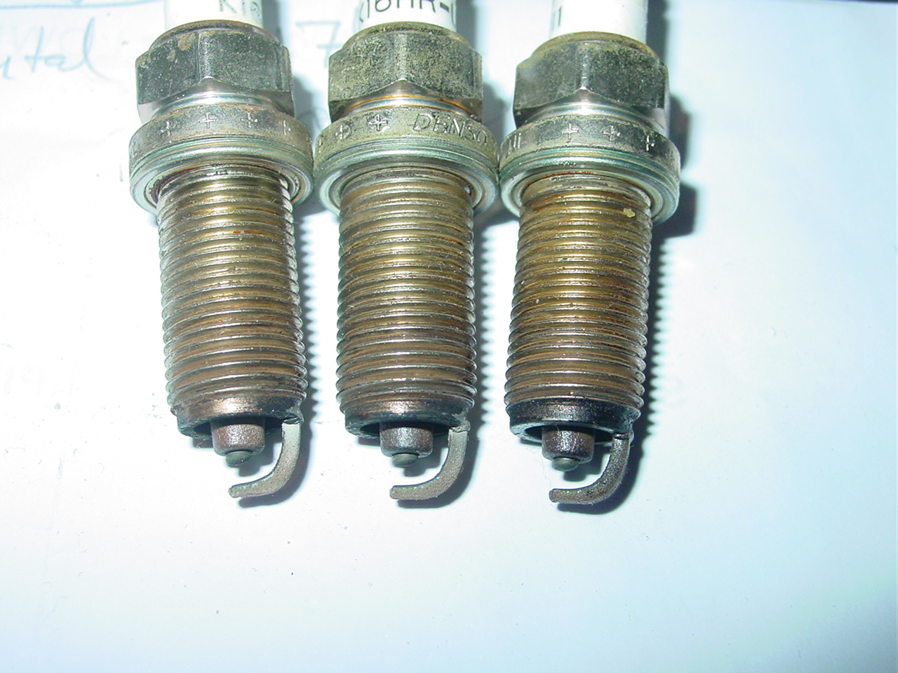

I had the engine anomaly light come on on Saturday. It had come on before, run on two cylinders, I ordered NGK plugs, then it decided to run properly again. So second time I changed the plugs.....and it still misfired.
I did a quick check and it was the #3 coil.
Ordered a QH part (25€) which will arrive end of the week but as it's my only running car I got a used Denso coil (another 25€) as it's not a smart idea to run on 2 cylinders.
It immediately ran perfectly with the new/used coil but the anomaly light is still lit!
Does this need removing on a diagnostic suite or is there a sneaky workaround?

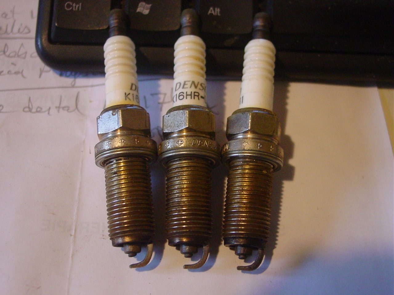

Oh yeah....check the plugs! I think they are the originals, 10 years and 135,000 km later. I wonder how many times the owner,(who had it from new) paid to have them changed?
What's the plug gap meant to be? These have to be 4mm +
You need to read the codes to find out what's stored, misfires are not always caused by plugs or coils
you could drive a bus through that gap, those plugs are (want for a technical description).................. shagged
Honestly i would put some Iridium plugs in the car they give a much cleaner spark (Denso IKH16TT)
Off the top of my head 1.1mm gap
edit. Here you go

It seems happy with it's new NGK plugs but I'm highly impressed that it was running well enough to give over 60 mpg on what has been politely referred to as 'totally shagged' plugs, a pretty accurate description.
In my many decades experience with IC engines I have never seen the like....it speaks volumes for Denso's quality.
