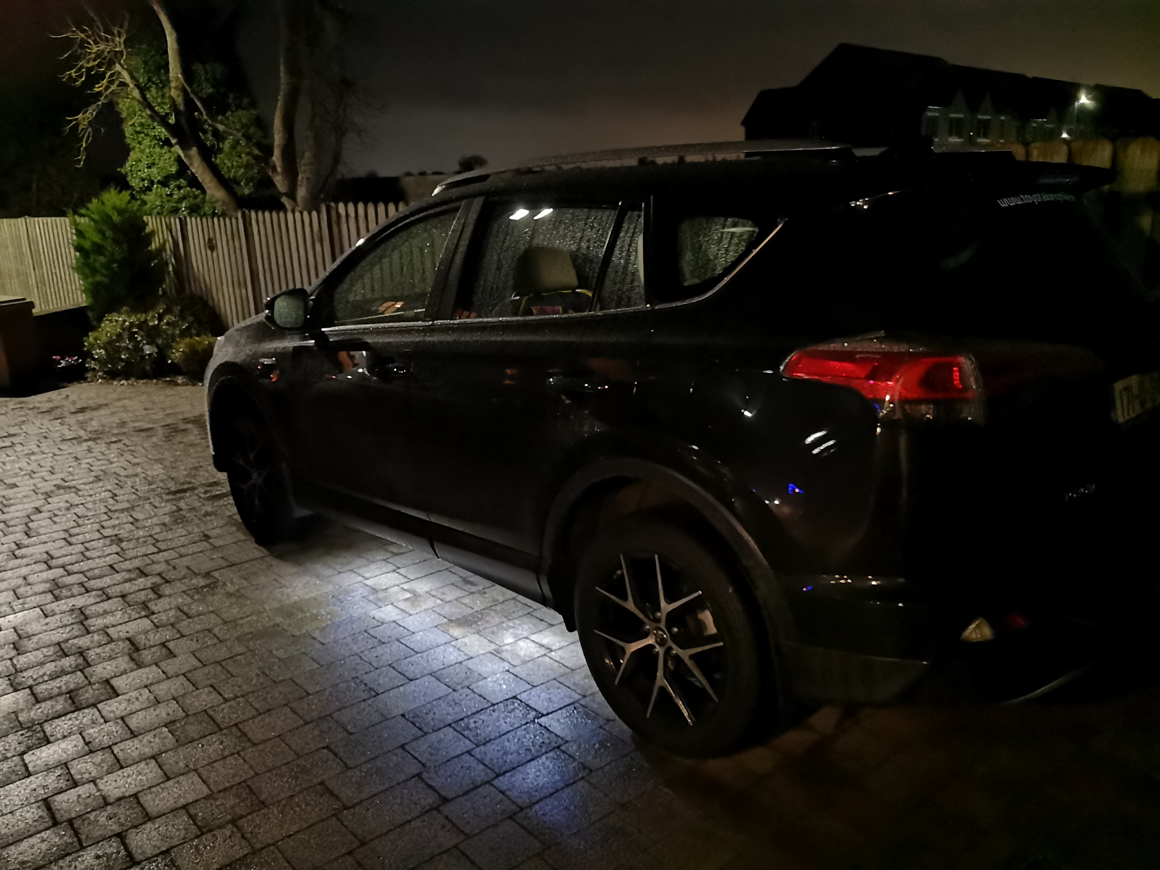

Here are the puddle/welcome lights on mine. OEM kit for Quasqai tapped into the dome light.
So they come on when you unlock car and interior lights come on ye? This would be possible to have lights in the underside of the mirrors poss some led strip
Correct. They turn on when I unlock the car, when I get close to a locked car and also when I open the doors. They are in sync with the interior dome light.
