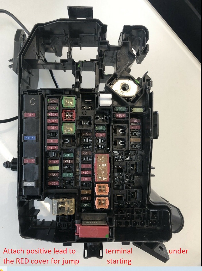

Gerg 372 Posted January 23 Share Posted January 23 There is a 'jump start' attachment point provided by Toyota for just this eventuality. It is inside the passenger-side fuse box that is under the bonnet. Remove the cover of this fuse box - the jump start point is under a small red plastic cover (with a positive sign set into it) that has a simple locking clip to undo one end. It then hinges up. This presents a blade that a crocodile clip of your jump leads will attach to. On the underside of the fuse box cover is a map/diagram of the fuse box if you cant find this. There is no negative connection provided to connect your other negative/earth jump lead to - you can use a nut on the suspension turret nearby, or any substantial shiny part of the chassis or engine. 1 Quote Link to post Share on other sites

1.8 hybrid 17 Posted January 23 Share Posted January 23 on our mk2 auris this is the under bonnet bonnet fusebox the RED cover hides the starting point yours i'm sure will look similar if not the same 1 Quote Link to post Share on other sites
DFT 2 Posted January 23 Author Share Posted January 23 Found the jump start point wish I had know about it before could have myself a load of time many thanks for the info, tried teaching wife about lights etc to no avail lol guess I’m lucky she remembers to bring the car home with her. 2 Quote Link to post Share on other sites
