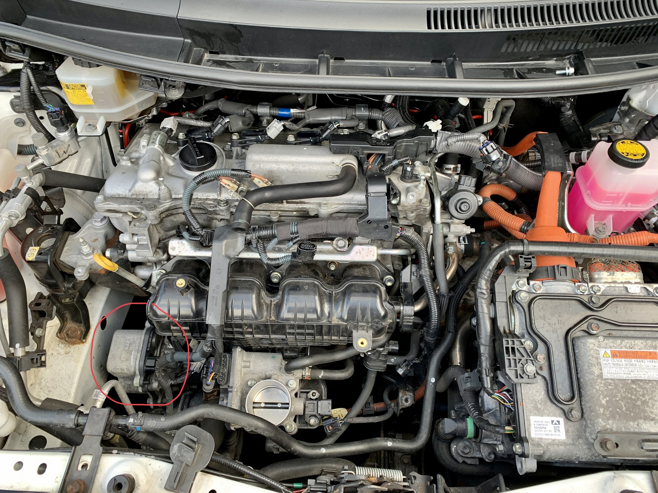

Hello Greenleaf, thanks very much for the reply. The water pump on the 1.8 Gen 3 is, of course, an electric one (no drive belt). Do you know if it is more expensive to replace than a conventional one? Is it a main dealer only job? Or can a good general mechanic do it? Thanks in advance for any replies, cheers, Mark
Hi Mark,
The water pump is around £250 when I last looked into this (but that was pre-Brexit!).  There are suppliers outside of the Toyota dealer network, including EuroCarParts etc. etc..  I can see no reason why it should be any harder than a normal pump, if anything a little easier (no drive belt to refit etc).  If it wasn't that you had to drain the coolant, then I'd expect it to be very easy indeed.
One poster on here, TonyHSD, was doing mega miles in his 2010 Auris hybrid, (so same engine etc.).  I have an idea his car is at 160,000 miles.  I don't think he has had any problems that way.  I have an idea that this is a 150,000+ miles issue, but I'm still looking for other people's experiences.  I'm not aware of any early warning signs of impending pump failure - it's not like they can leak, as a normal one would, as they are sealed from the outside world!
Hi,
water pumps are electric but that’s only how they spin otherwise same as any standard water pumps. Since they don’t spin all the time and when they do, they spin at different speeds than the crankshaft they are likely to last longer than conventional pumps, changing coolant regularly I believe also helps prolong the life of it. I don’t see a reason to change the pump or thermostat before it’s gone since if any of those  is not working you will get info on the dash and temp gauge will go up, also if the turbine it’s gone you will loose heating as coolant won’t be able to circulate the system, once all or any of these signs occur changing the pump it’s easy task , just 5 bolts and it’s off the engine. Price is high though therefore I am keeping mine until I notice malfunction for now. These also can be tested on the car with diagnostic tools and see if the operational.
Thanks very much for the info Gents. £250 is slightly steep, but not the end of the world, although I would see if I could get one from Blue Print (I've always used Blue Print on my Japenese cars, both Toyota and Honda employees have told me they are up to origanal standard), Cheers, Mark
