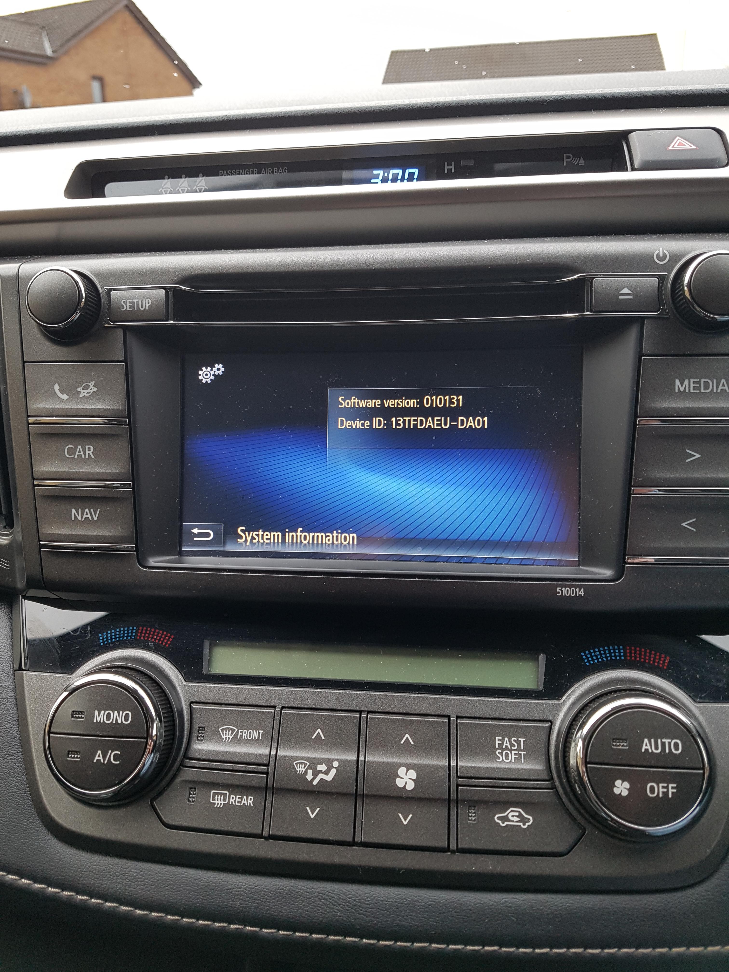

Ian Osprey 0 Posted January 29 Share Posted January 29 Hi I have a 2015 RAV4 Invincible that doesn't have SatNav. It does have a reverse camera. The head unit is a 510014(see photo) Toyota want £870 to add that functionality. Is it a case of swapping head units? That is can i simply change to a unit from an AYGO, for instance? Is there an option to mirror an android device onto the car's media screen? I ask as when I plug my phone into the USB connection, my phone says "phone is connected to your car via mirroring" then goes blank, but I don't see it on the car's system. Finally does anyone know a tried and tested 3rd party way to mirror my phone to the car's system. Thanks, Ian. Quote Link to post Share on other sites
FROSTYBALLS 3,425 Posted January 29 Share Posted January 29 The Aygo multimedia system (shared with the Peugeot 108/Citroen C1) is a completely different system to yours, which would be a Touch 2. The cost of adding the sat nav module would also include fitting the gps antenna. Quote Link to post Share on other sites
