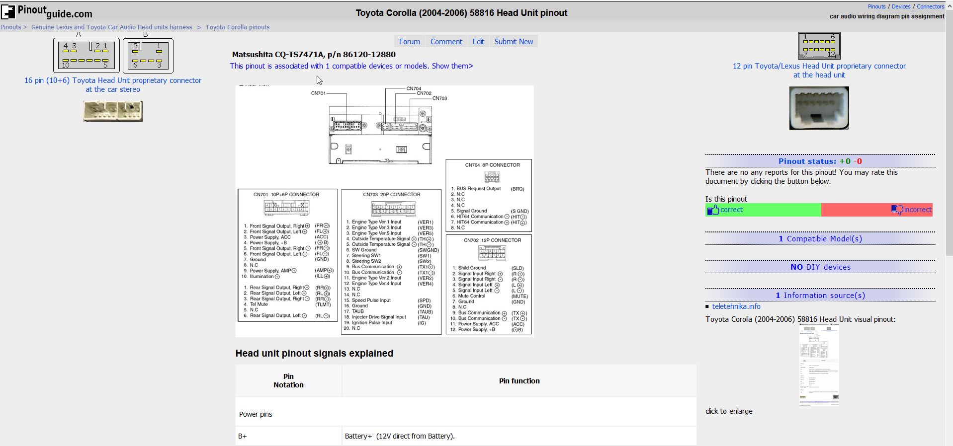

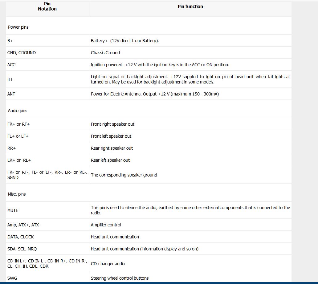

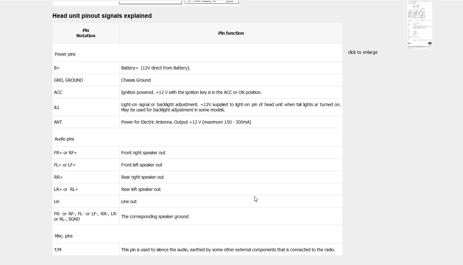

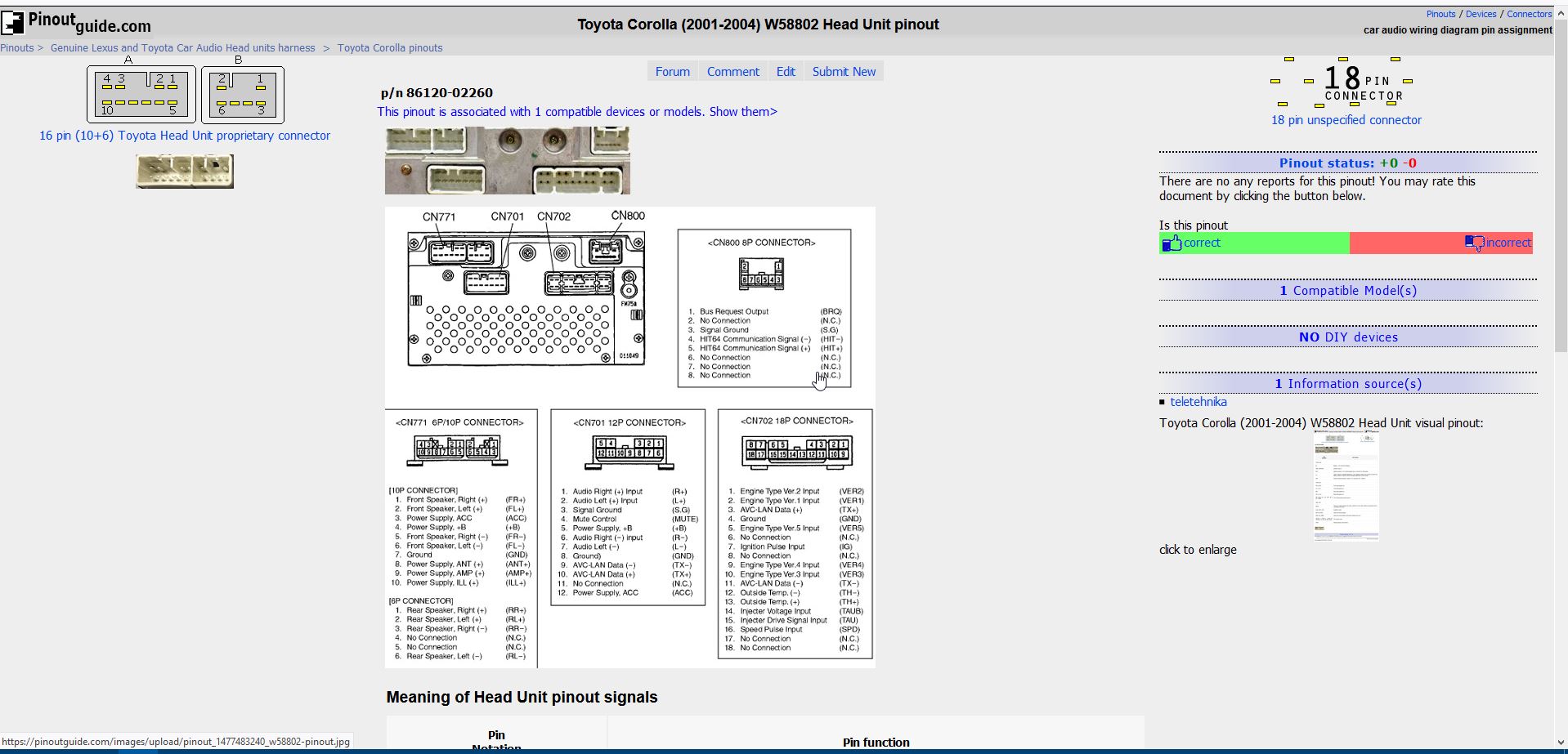

oldcodger 342 Posted February 5 Share Posted February 5 Hi, These diagrams should help, just check which model you have fitted. It does sound like a damaged cable or faulty parts inside the head unit, has it ever blown its fuse ? While checking the wires to the Speakers, open and shut the doors as the movement might be causing a break or short where it passes by the hinge. If looking for a new head unit, you need to check in detail, but many of the newer ones have displays where you can change the colour of the leds so you can match it with any dash layout, so widens your choice of unit, at a price. Quote Link to post Share on other sites
