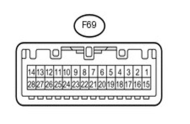

The Mk2 appears to have a 4/6 pin connector block on the back of the head unit AND the “factory fit” camera.  So, it the wires are pre fitted in the boot area, then you could buy a factory fit/2nd hand factory fit camera and off you go.
If the existing wiring does not contain the connector block, then I would guess it starts getting (relatively) expensive.  The cameras alone are going for about £50 on eBay (2nd hand), compared to about £10-£15 for a new “standard” one without the block.
So if the block in the boot isn’t there, you’d probably be looking at (if keeping existing head unit), wiring from boot to head unit, camera with connector block.  Starts getting expensive.....
