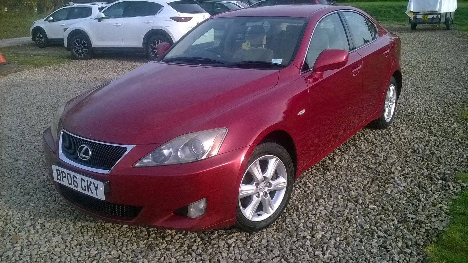

Auris James 130 Posted February 7 Share Posted February 7 I had a Lexus IS220D with the same 2.2 diesel. I got tempted by a nice looking example with high mileage. 173,000miles Paid £1,475 for it. My biggest waste of money! Fitted new AC condenser. Used full size wheel as space saver damaged. Then new Avon ZV7 tyres all round. After 18 months and 187,000 miles, started to pressurise and dump coolant out of coolant reservoir vent pipe. Got far worse over a few months and didn't drive it as could overheat as it was loosing it so fast. Tried K seal but it didn't work. Last resort as not worth spending on. If you are going to fix existing engine K seal and others can block coolant galleries apparently. Ended up getting £350 in scrap for it on Ebay. Hated the poor economy around 33-38mpg 6 speed gearbox unusable too much turbo lag. Build quality apart from engine great and comfy. You would be better off finding a good used engine and once fixed PX ing it. Got an Auris hybrid now and it's great. Quote Link to post Share on other sites
Auris James 130 Posted February 7 Share Posted February 7 3 minutes ago, Auris James said: A photo of it just before collection. Buyer delighted with the alloys and tyres. As alloys nice and tyres only 2 months old! Quote Link to post Share on other sites
