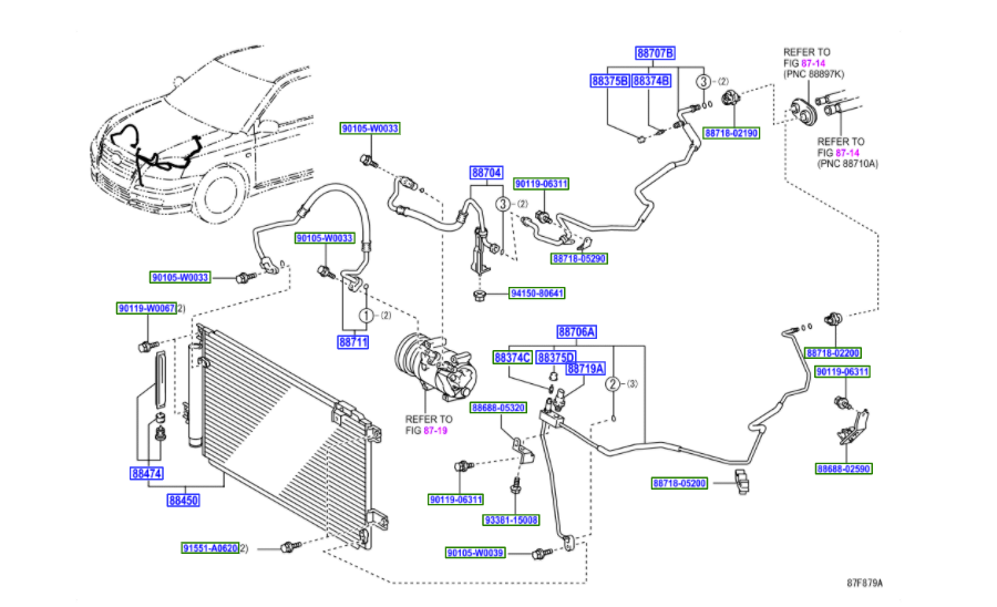

Looking at Toyota EPC online, I have narrowed it down to this part n°; 88688-88706A
It's the high pressure pipe from the evaporator to the condensor.

It take it is PNC 88706A in pic attached?

It's the high pressure (liquid) pipe from condenser to evaporator, the long thin 8mm aluminium one.
Then by the picture it should be 88706A this comes from the evaporator join at the bulkhead down the passenger side of the engine bay to the condenser.
Part number for your chassis:
88716-05550 Pipe
90099-12141 x3 O ring
