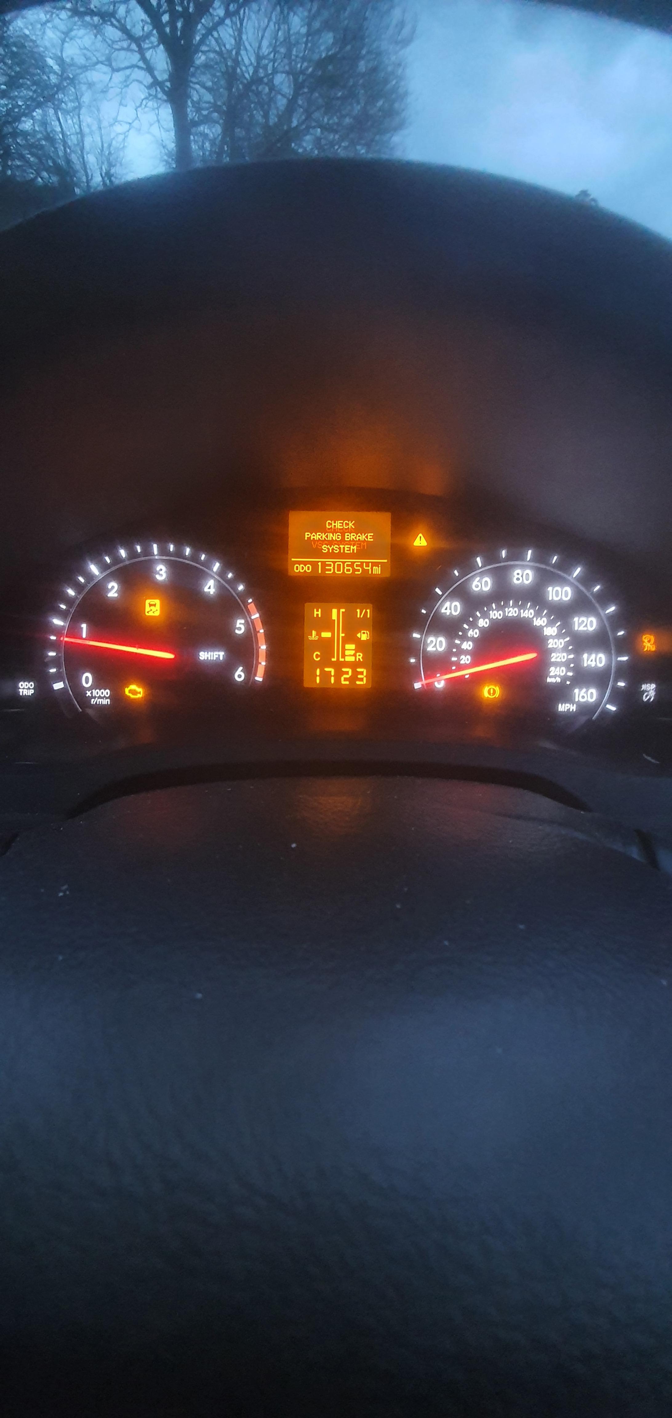

Cathal McLaughlin 0 Posted February 8 Share Posted February 8 Hi, I have a 2012 Toyota Avensis ERZ 7614, with 5 amber lights coming on. The only issue is the automatic handbrake does not come on automatically so has to be done manually. This is the only issue it causes. Is it possible to have information as to how to fix as I have just bought a RAV4 and want to sell the avensis. Cathal. Quote Link to post Share on other sites
yossarian247 166 Posted February 9 Share Posted February 9 You need to have the fault codes read to establish what the fault actually is. Pretty much any fault with the fuel system, engine management system or pollution control will cause those 5 lights to come on and the auto parking brake not to work. Without knowing the fault code it's guesswork. It may be that the EGR valve is blocked, but I wouldn't assume that at this stage. Quote Link to post Share on other sites
