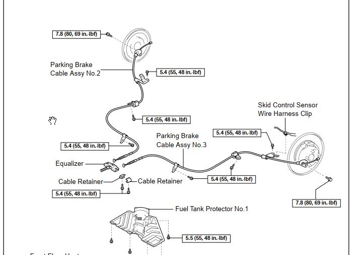

tarantula_123 6 Posted February 9 Author Share Posted February 9 On 2/8/2021 at 9:20 PM, oldcodger said: Would think our standard rolla is virtually the same are yours handbrake wise. Assume you have taken up the slack on the handbrake lever inside the cabin as much as possible ? Also the drum part of the rear brake has not been worn beyond its limit ( unlikey as the disc part should have worn out first) and that the shoes are good. Its a bit of a pain to get at the three cables equaliser assembly behind the exhaust where they all connect and found connecting them to the shoes difficult as well, one of those jobs practice makes perfect ! The biggest problem is getting the right parts, from Mr.T clearly no problem , but as I found using other suppliers, the RH cables fittings were the wrong type, seems there are variations in fittings and possibly length, even on the standard model so no idea on the TS, so check you can return them for the right part or refund before purchasing from elsewhere. Thanks for that. So to be correct, there are actually 3 handbrake cables on the Corolla.... one at the front that goes back, along with the ones at the two rear brakes? I'll have a good go myself for sure. Is there any issues with removing the exhaust heat shield and stuff like that? I will more than likely sadly be selling her after I have finished the stuff I need to first. Quote Link to post Share on other sites
oldcodger 340 Posted February 10 Share Posted February 10 Yes, three the two rear ones and one short from the handbrake lever to the equalizer. All the nut came off ok, its holding the cables in place on the equaliser thats fiddley. Just be sure you have the correct cables with the correct end fittings before removing the old ones. As always Mr T prices are high, but you should get the correct ones. Why selling ? Quote Link to post Share on other sites
