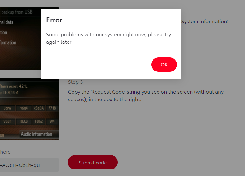

VeryRAV4 2 Posted February 15 Share Posted February 15 I'm having problems updating the SatNav Map file on a 2019 Mark V XA-50. One poster on the Corolla forum cautions that failed updates can lead to a "bricked" head unit. Followind the DIY guidance obtained from the local dealer, I've located the free file in the e-Store (apparently we are entitled to upgrades for 36 months from date of first use). but when I select it and go to enter the Toyota Request Code (retrieved form the head unit) I receive this message: I have raised a Toyota CR CASE number but the last reply from them simply said: "this issue logged with our dedicated IT department as their is an issue with the request code. I will update you as soon as I hear back from them, this can take some time depending on the complexity of the case." The request code was retrieved form the device and has been carefully entered. The device ID at My.Toyota was originally set to my previous Mk4 but now tallies with the correct vehicle. Anyone experienced anything similar to this? I am not confident that Toyota have this issue nailed so would be grateful for any input. Quote Link to post Share on other sites

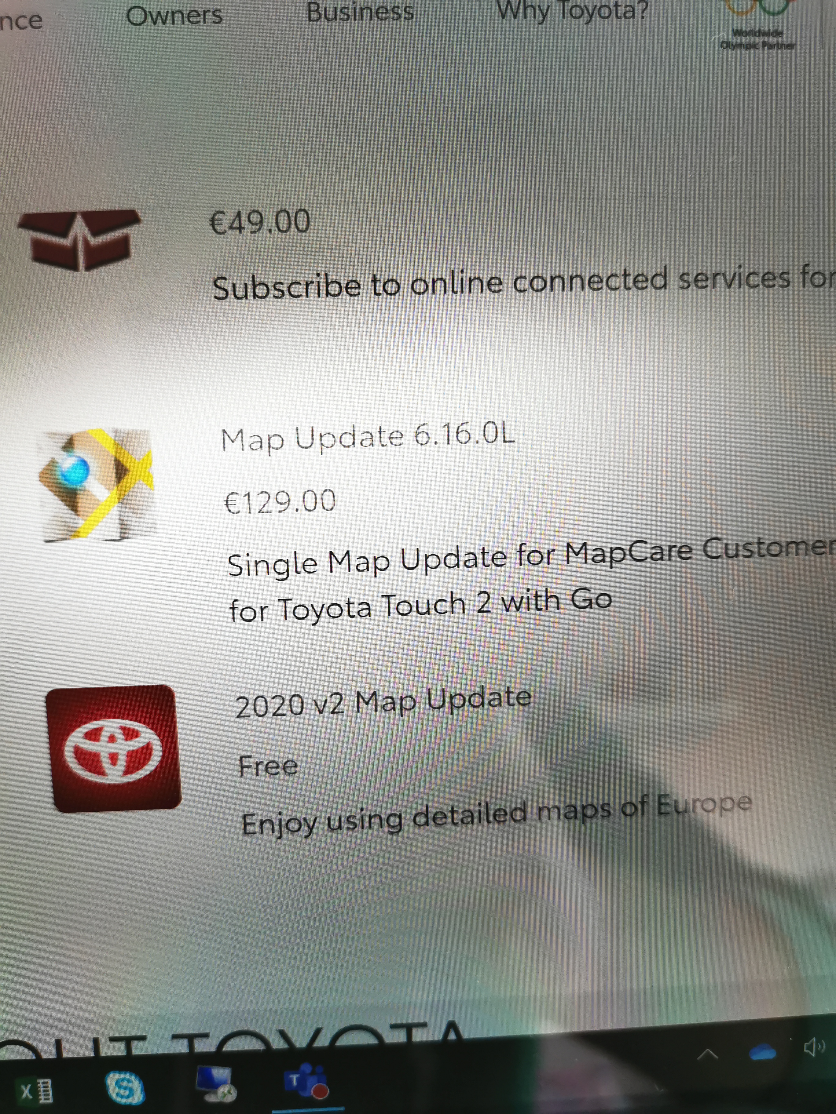

raf82 4 Posted February 16 Share Posted February 16 19 hours ago, VeryRAV4 said: I'm having problems updating the SatNav Map file on a 2019 Mark V XA-50. One poster on the Corolla forum cautions that failed updates can lead to a "bricked" head unit. Followind the DIY guidance obtained from the local dealer, I've located the free file in the e-Store (apparently we are entitled to upgrades for 36 months from date of first use). but when I select it and go to enter the Toyota Request Code (retrieved form the head unit) I receive this message: I have raised a Toyota CR CASE number but the last reply from them simply said: "this issue logged with our dedicated IT department as their is an issue with the request code. I will update you as soon as I hear back from them, this can take some time depending on the complexity of the case." The request code was retrieved form the device and has been carefully entered. The device ID at My.Toyota was originally set to my previous Mk4 but now tallies with the correct vehicle. Anyone experienced anything similar to this? I am not confident that Toyota have this issue nailed so would be grateful for any input. I have the MK4 model. I think you may be going to the wrong map file in the e-store. I had to select 6.16.0L map update which initially had a cost associated to it but then it zeroed in the basket and was free of charge. It also helps if you log in to your Toyota account on your head unit. That just automatically links your unit to your profile. Quote Link to post Share on other sites
VeryRAV4 2 Posted February 16 Author Share Posted February 16 Thanks for the replies. 11 minutes ago, raf82 said: I have the MK4 model. I think you may be going to the wrong map file in the e-store. I had to select 6.16.0L map update which initially had a cost associated to it but then it zeroed in the basket and was free of charge. It also helps if you log in to your Toyota account on your head unit. That just automatically links your unit to your profile. Quote Link to post Share on other sites

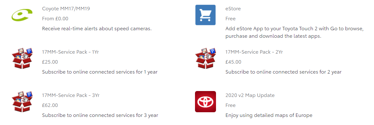

VeryRAV4 2 Posted February 18 Author Share Posted February 18 Toyota are still working on the map update issue. Meanwhile, this is the e-Store options that I am currently presented with. Previously there had been a "6.10.0H" (Sept 2017) file as well as the 6.16.0L (August 2020) referred to above but these have disappeared from my menu. I would be grateful to know if other owners can see the 6.16.0L at this time? Quote Link to post Share on other sites

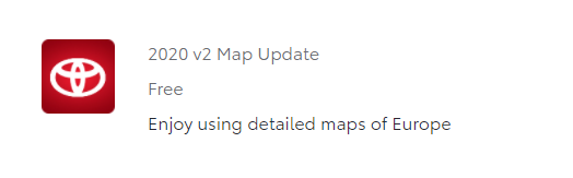

Zoot2 10 Posted February 19 Share Posted February 19 1 hour ago, VeryRAV4 said: Toyota are still working on the map update issue. Meanwhile, this is the e-Store options that I am currently presented with. Previously there had been a "6.10.0H" (Sept 2017) file as well as the 6.16.0L (August 2020) referred to above but these have disappeared from my menu. I would be grateful to know if other owners can see the 6.16.0L at this time? If you press “maps” in the e-store the 2 apps are listed. Oddly they are not listed in the “all” section of the e-store apps. Hope this helps. Quote Link to post Share on other sites

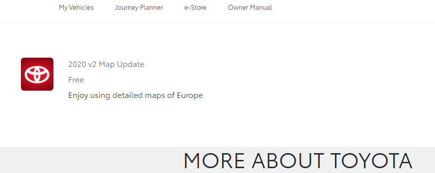

VeryRAV4 2 Posted February 21 Author Share Posted February 21 On 2/19/2021 at 12:15 AM, Zoot2 said: If you press “maps” in the e-store the 2 apps are listed. Oddly they are not listed in the “all” section of the e-store apps. Hope this helps. Thanks for the information. It seems that the problem is with my vehicle, because the "Maps" tab only shows the one file. Quote Link to post Share on other sites
