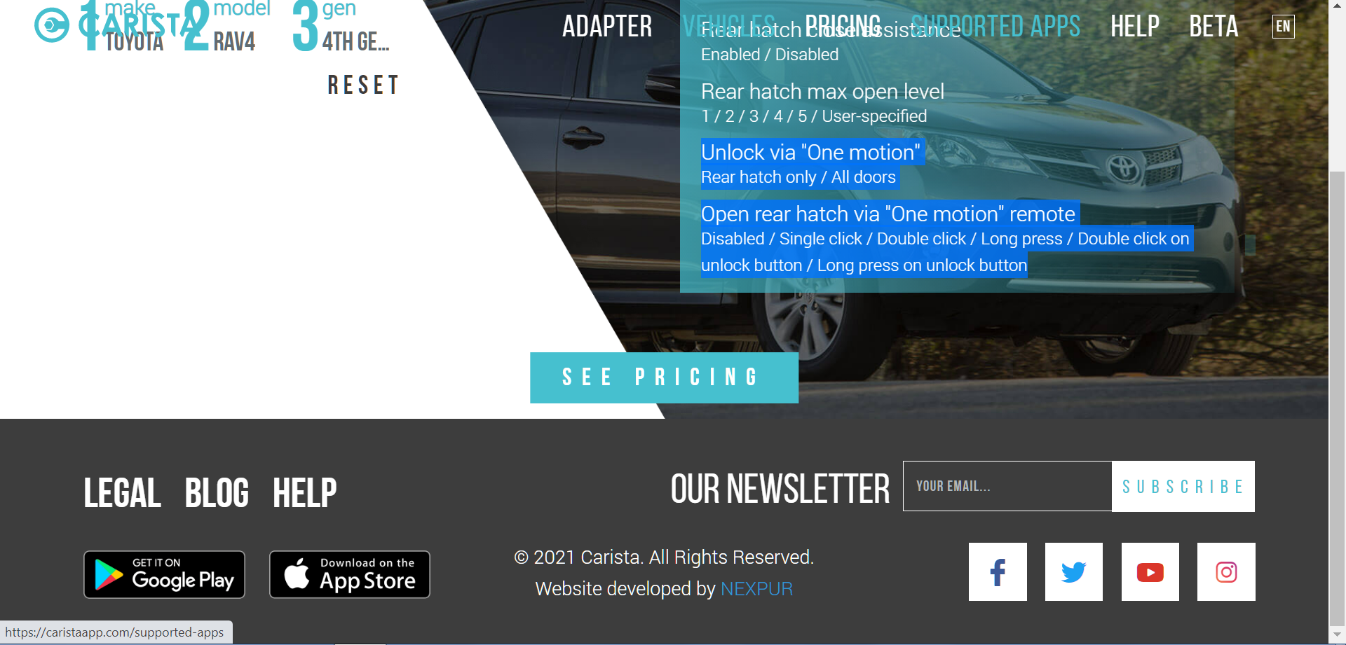

On the Carista phone app, they list some of the customizations that are available.  For the last  model of Rav they listed this:-
Which looks promising. They don't list it for your model, but that's probably an oversight.
HTH
