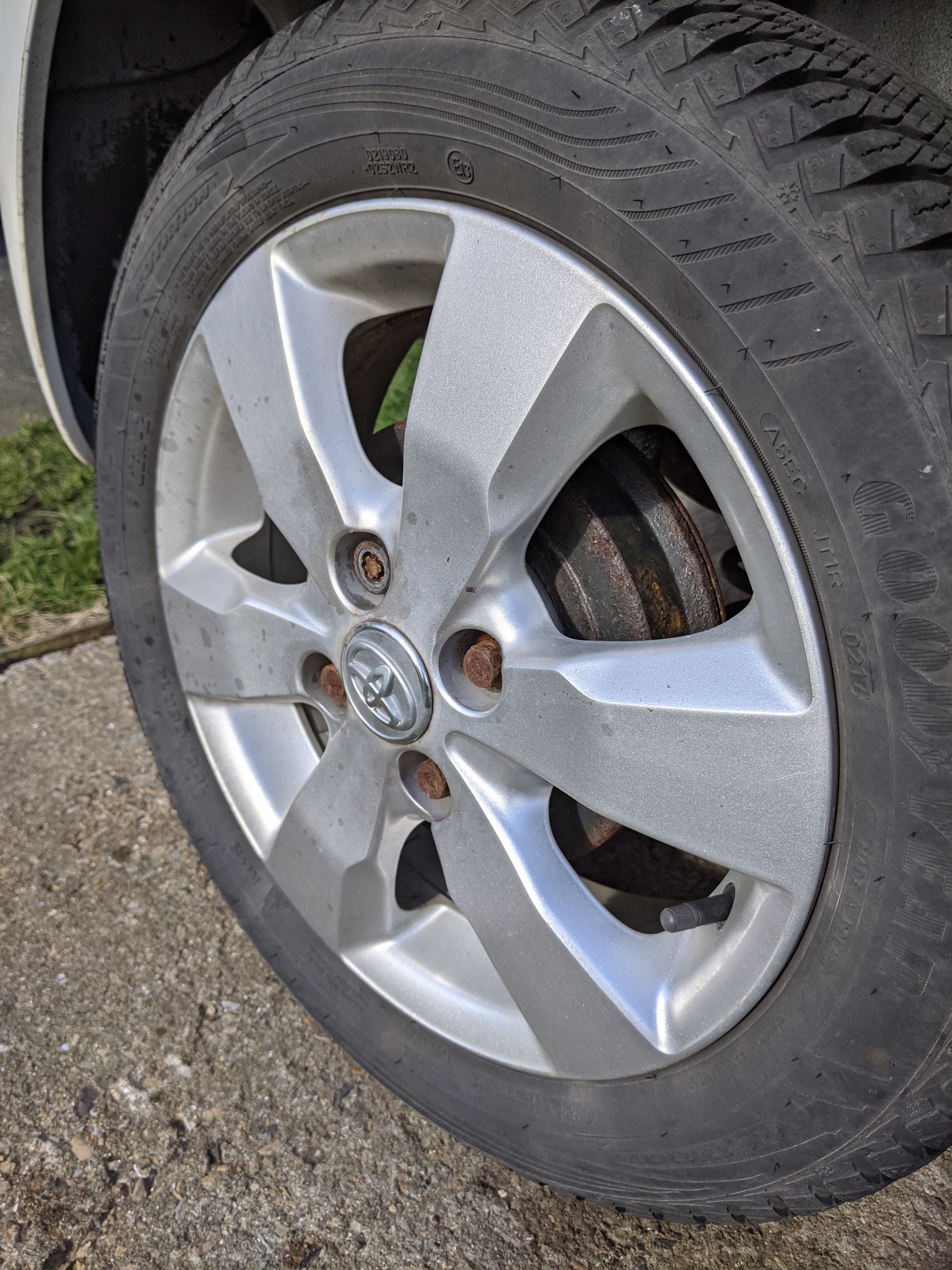

I want to replace all my locking wheel bolts with standard ones, after a battle today trying to remove the locking wheel bolts.
Could someone please guide me to where I can buy 4 x standard bolts for OEM Aygo 14" alloy wheels, 155/65R 14, 2013 model FIRE. Even if the dimensions of a bolt can be posted and I'll do the donkey work!
I have posted a picture of my wheel for reference, as I'm not sure if there were different wheel options at time of manufacture.

The oem is 90942-W2003 - M12x1.5, 21mm long

Just in case anyone else wants to do the same thing, I sourced replacement bolts from this site:
https://citybugstore.co.uk/citroen-c1-2005-2013/clutch/wheel-nut-/-bolt-alloy-wheel.html
Had emailed them before purchase and got a really quick reply, stating that these were the correct fitment.
