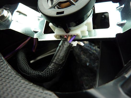

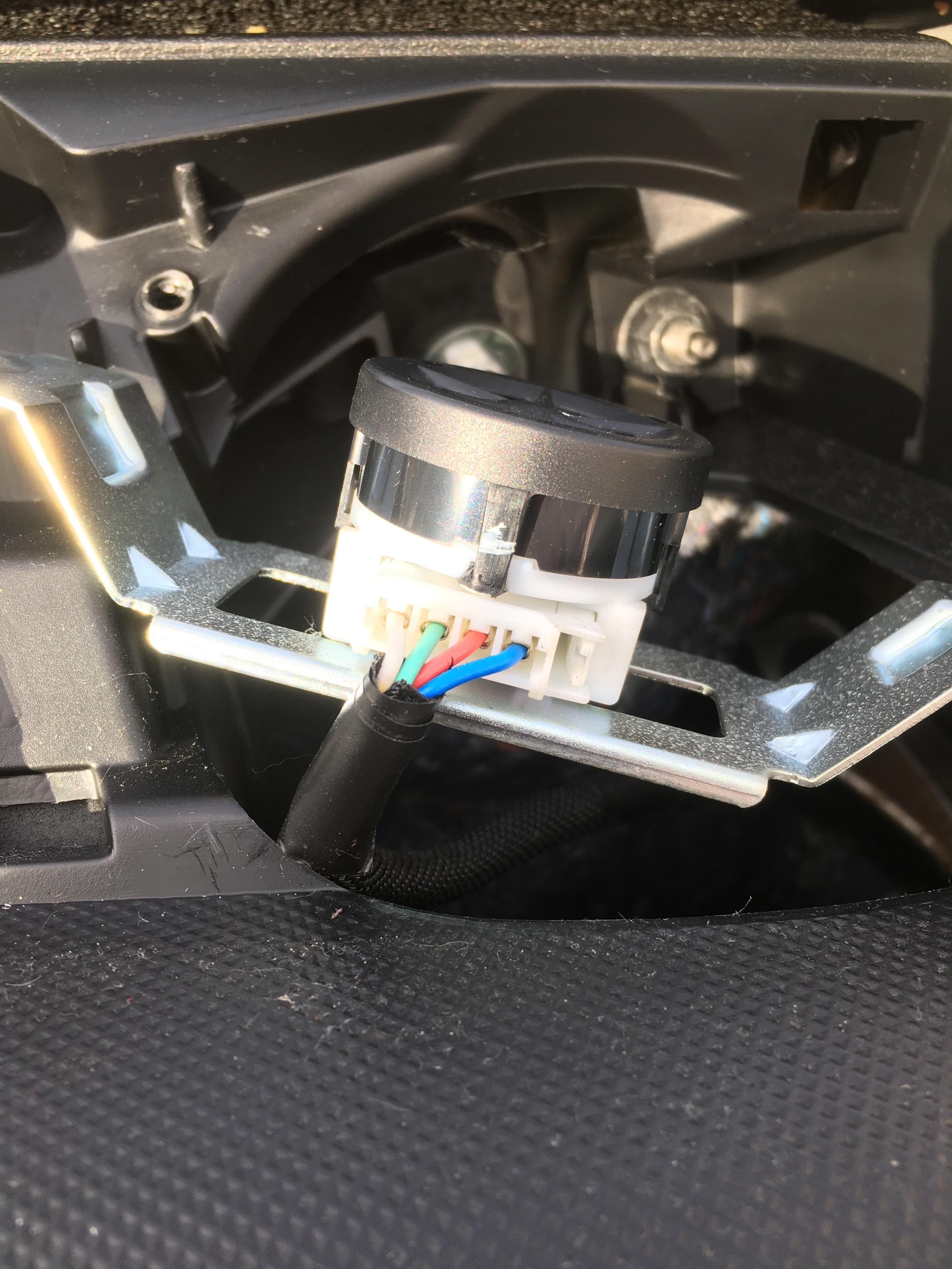

MCjensen 1 Posted March 8 Author Share Posted March 8 2 hours ago, flash22 said: @MCjensen are you sure you have speakers in the front doors the factory speakers come in 3 specs, base spec 10cm (4") - Mid spec 10cm in the dash (with factory high pass filter) 16.5cm mids in the front and the High spec what's the same as the mid-spec but with 16.5cm in the rear (full range) I have a 17cm in the door, not sure exactly what kind it is, except its original. I have the 4cm original ones in the dash, that look like tweeters I guess Quote Link to post Share on other sites
MCjensen 1 Posted March 8 Author Share Posted March 8 My tweeter in the dash Quote Link to post Share on other sites
flash22 751 Posted March 8 Share Posted March 8 Alpine SXV1025s are good for the money match them with SXE1725s for the doors, If not go with comps like alpine SXE1750s mount the tweeters in place of the 4" they will require a bit of wiring Quote Link to post Share on other sites
flash22 751 Posted March 8 Share Posted March 8 Ah you have the upgraded Speakers, 4 wires on the tweeter 2 from the radio 2 to the door, the tweeter acts as a crossover Quote Link to post Share on other sites
MCjensen 1 Posted March 8 Author Share Posted March 8 36 minutes ago, flash22 said: Ah you have the upgraded speakers, 4 wires on the tweeter 2 from the radio 2 to the door, the tweeter acts as a crossover Should I leave the upgraded tweeter in the dash then? Quote Link to post Share on other sites

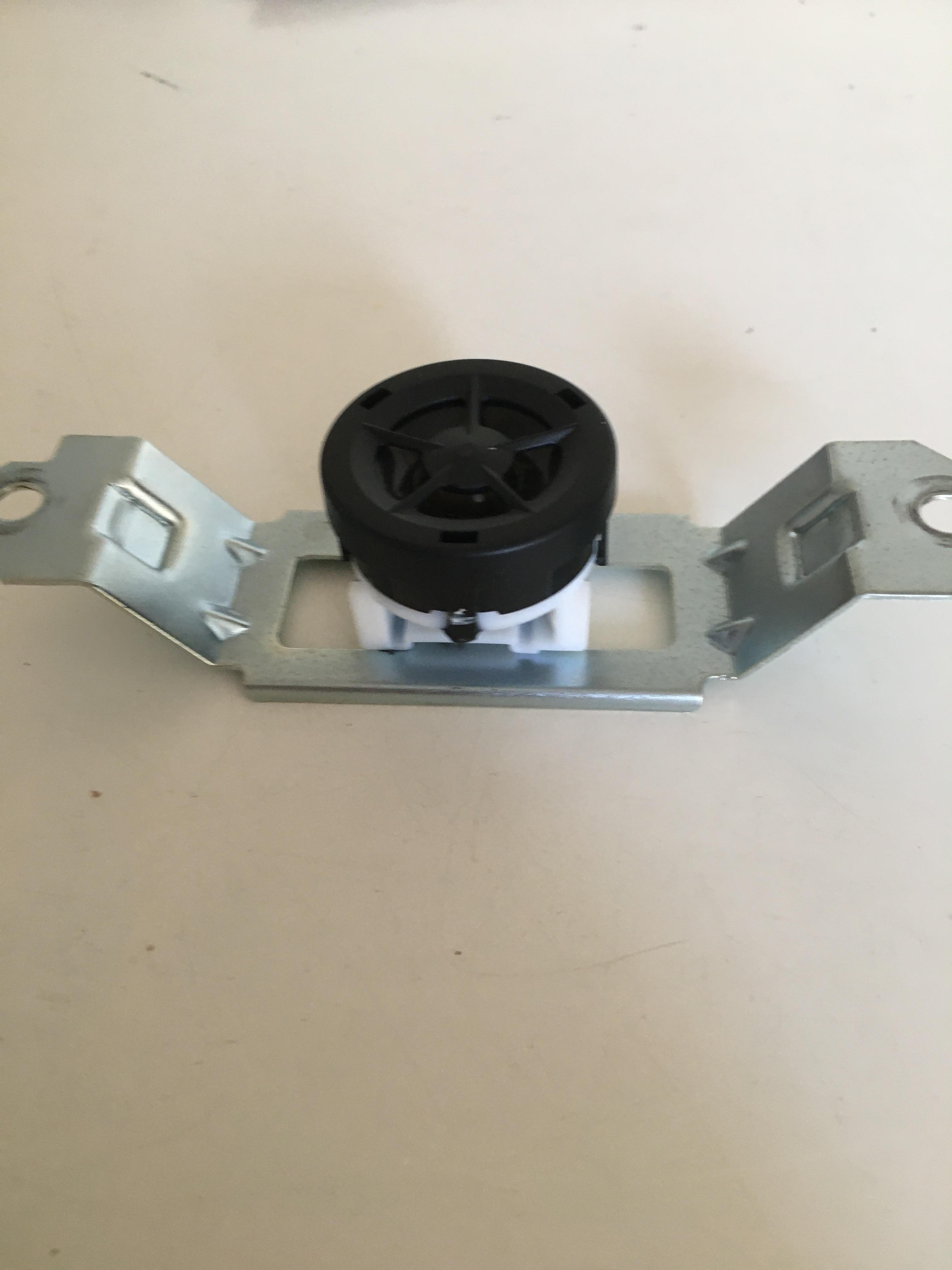

MCjensen 1 Posted March 9 Author Share Posted March 9 (edited) Considering to improve the car stereo sound, I'm looking at these speaker systems with Hertz in this particular example to go with my original bluetooth pioneer HU in the 2012 Aygo+ I guess I have 4 basic choices. I appreciate any suggestions. 1- Replace both the front door Speakers and the dash tweeters. Not sure yet how to fit or wire the new tweeter on the original metal frame. DSK 170.3 two way system https://www.hertzaudiovideo.com/car-audio-systems-dieci-dsk170_3/ 2- Replace just the front door Speakers but leave the exiting dash tweeters for now. DCX 170.3 Two way coaxial https://www.hertzaudiovideo.com/car-audio-coaxials-dieci-dcx170_3-2/ 3- Replace the front door Speakers but replace the dash tweeters with 4" coaxial two way Speakers. Not sure if the original HU can power them. DCX 170.3 Two way coaxial https://www.hertzaudiovideo.com/car-audio-coaxials-dieci-dcx170_3-2/ DCX 100.3 Two way coaxial https://www.hertzaudiovideo.com/car-audio-coaxials-dieci-dcx100_3/ 4- Replace the front door Speakers and the dash tweeters with a component speaker system. Think I could put the crossovers just under the dash tweeters. If my original HU can't properly power them, I could put in an aftermarket pioneer bluetooth HU I took out of my Fiat. Though the display is not that great, and the buttons are small.. Hertz Dieci DSK165.3 - 6,5" Component system https://customaudio.dk/shop/hertz-dieci-dsk165-463p.html Edited March 9 by MCjensen added component system url Quote Link to post Share on other sites
MCjensen 1 Posted March 9 Author Share Posted March 9 screw holes are 12cm apart for a coaxial speaker, funny underneath the tweeter is a hole to the floor. I see I can put a new tweeter on top on the metal plate tweeter with built in crossover Quote Link to post Share on other sites
