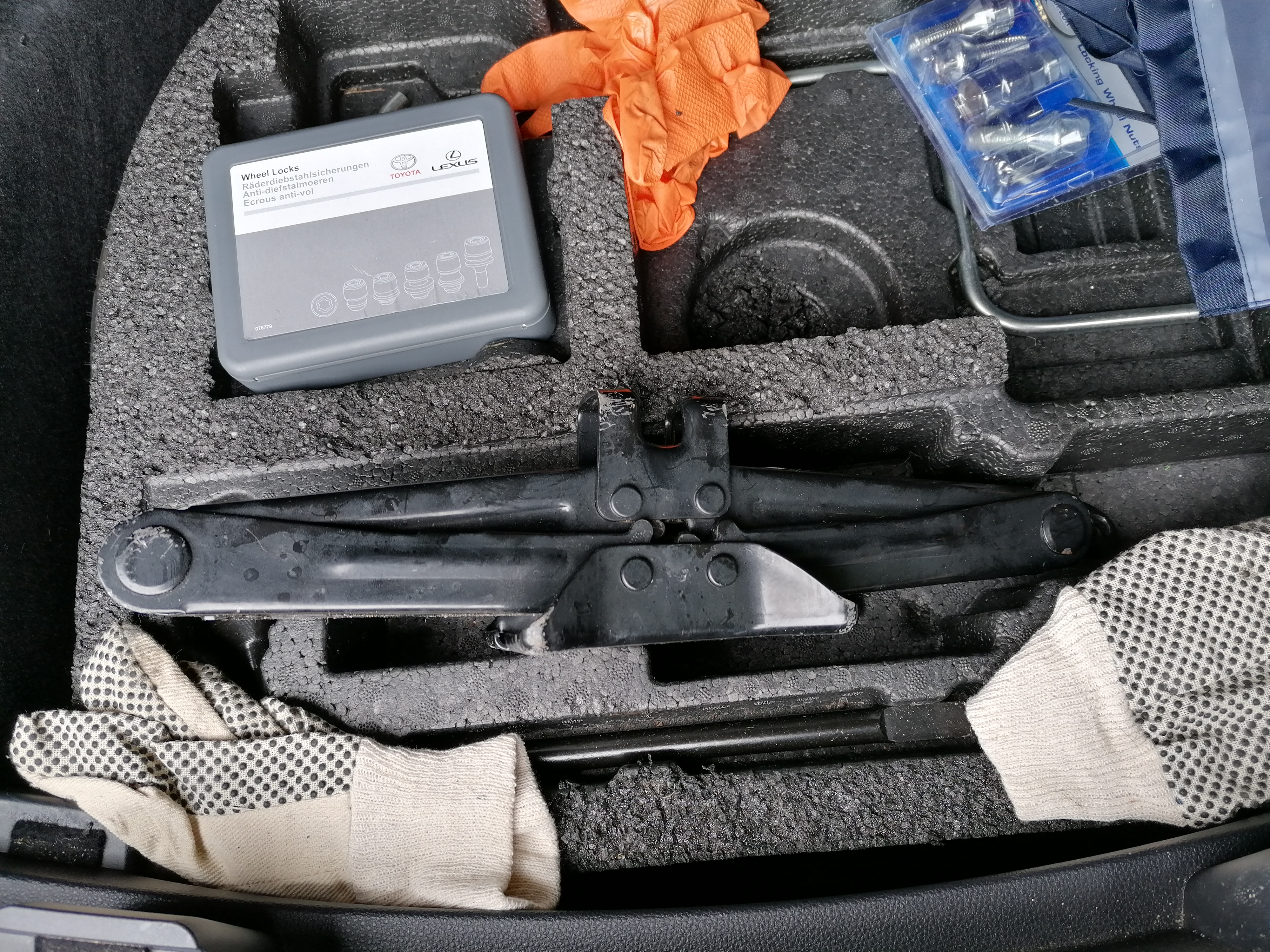

I've been looking on ebay etc for a compatible scissor jack for my 2020 Corolla TS. Even with OEM Toyota Jacks there seem to be two types of connecting plate (the bit that makes contact with the sill). Some have a 'slot' and others don't. My Auris had a slot and expected the Corolla to be the same. Is there anyone with a spacer saver kit who can clarify the correct jack type please?
 Hi I am using an Auris one as per attached photo along with a 17in Auris space saver. Jack fits Corolla fine as I had a tyre blow out.
Thanks - that's perfect.... looks identical to my Auris tools 👍

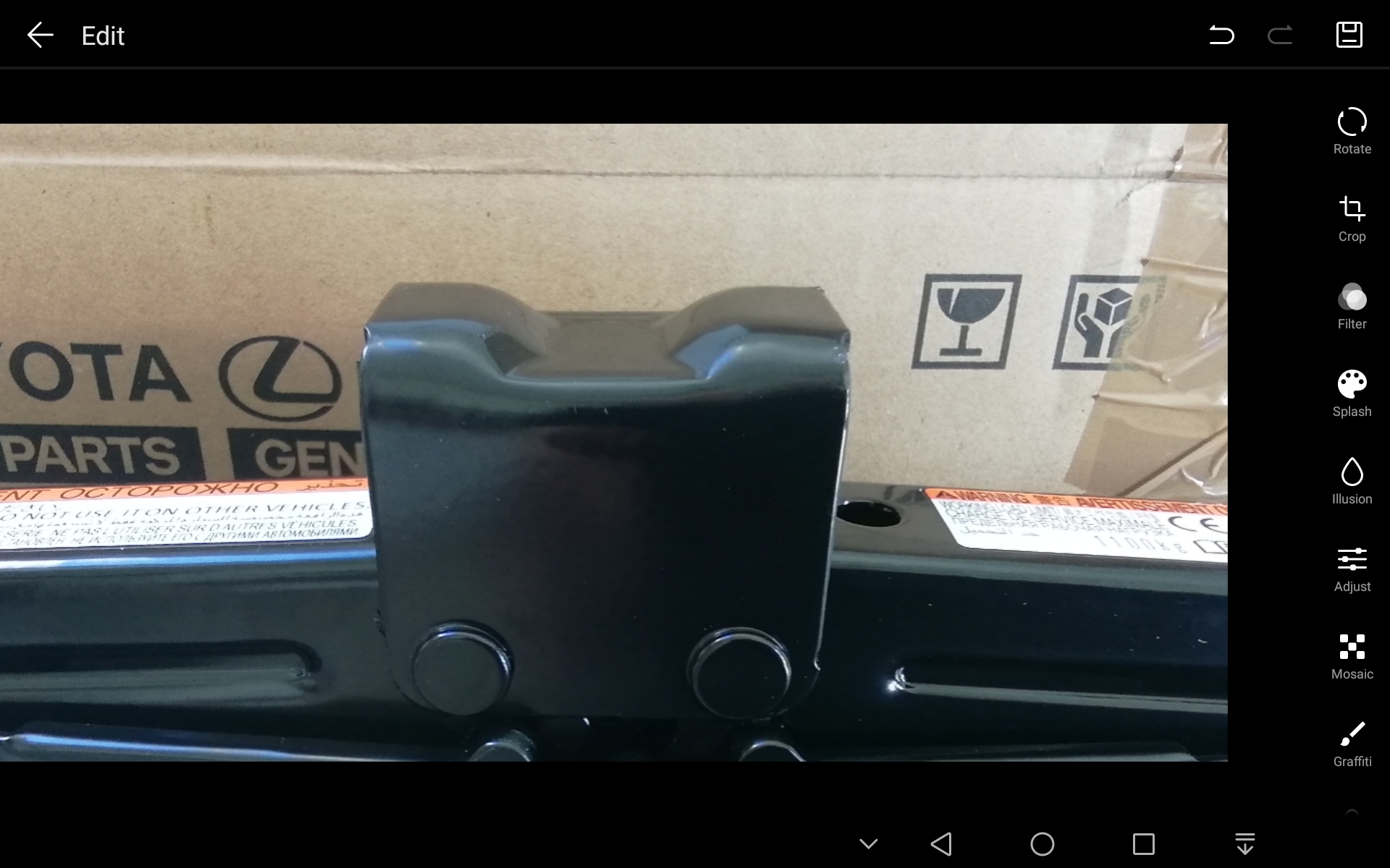

Well after all that faffing about with which type of jack to get ie slotted or 'dished with no slot' I decided to play safe and go down the Toyota Parts Direct route and order the correct part with the slotted head as clearly shown in the photo below.
https://toyotadirectparts.co.uk/parts/toyota-corolla/corolla-mk12-2019-present/accessories-corolla-mk12-2019-present/toyota-corolla-2019-present-jack/
Sods law though - I've received one without the slot (I suspect it may be the CHR fitment?). You couldn't make it up!

I've received a reply from Toyota Parts Direct to the effect that the jack IS the correct on for my car and that the (wrong) photo on their website was 'for reference only' and therefore shouldn't have been relied on. I've asked them to update the picture to show the item they actually supply to avoid others being mislead. They've offered to supply an older 'slotted' version at a cost of >£40 incl postage and accept a return on the current one, subject to me paying postage (which would be more than the £8.48 refund) .
Onyhoo...what to do? It's back to my original question... does it matter which type of head the jack has? My initial concern arose out of reports on this forum a few years ago about Auris's having their sill seams flattened by tyre fitters using jacks without a slotted puck.
Anyone with a factory supplied space saver and jack who can confirm what Toyota supply with a 2019-onwards Corolla TS??
