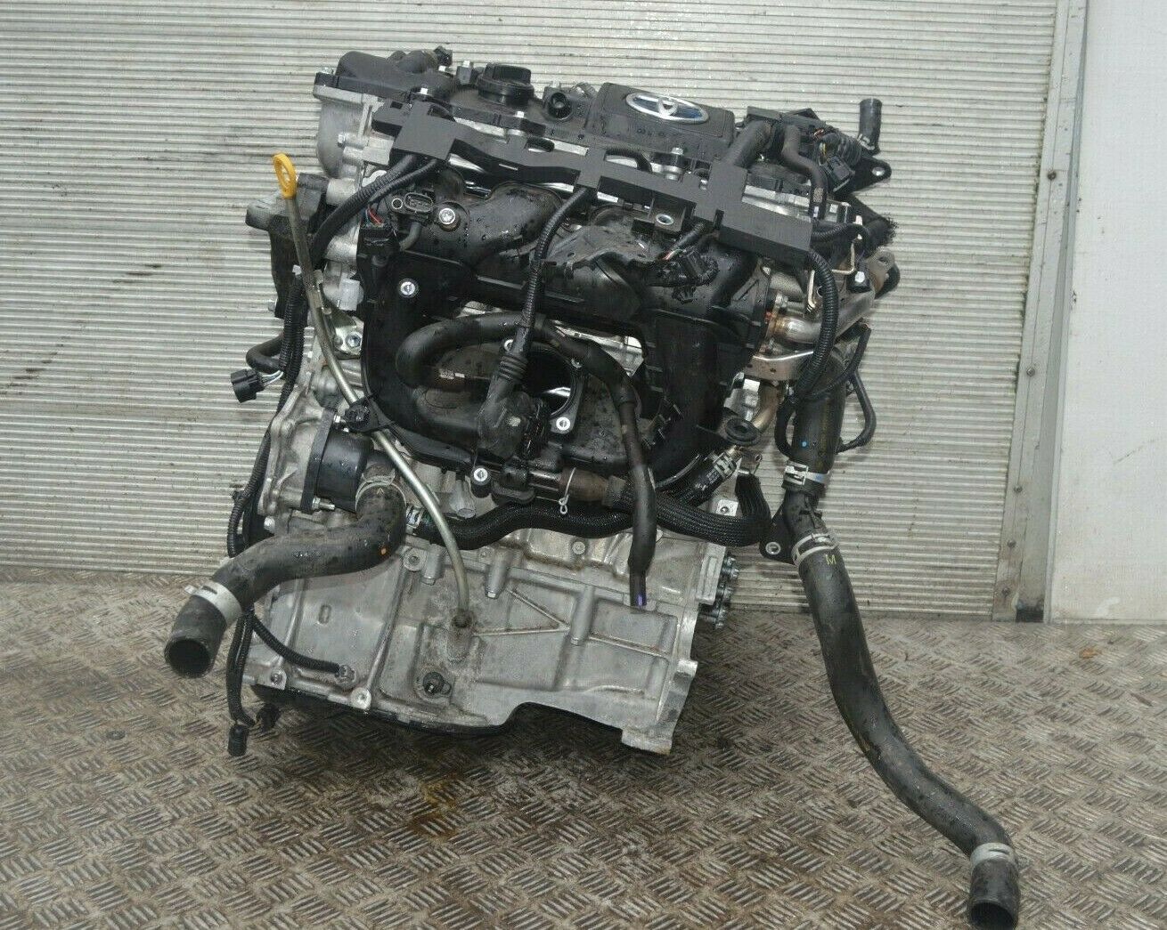

Went to check the Oil level this morning, because I'm that sort of guy. Car has been stood in the garage for 48hrs. Took a great deal of effort to pull the dipstick out and it came out with a metallic scraping noise. Cleaned it off and put it back to check the level and it didn't want to go back in. The angle appears to be critical, but it is difficult to see which way the tube bends as it goes down below the manifold. Eventually it went in all the way with the last 2 inches making a metallic scraping noise. It is obviously a tight fit and withdrawing the dipstick pulls Oil up the tube so putting it back in for a reading is a waste of time as it is way over the full mark. I eventually got a clear reading (normal full) after waiting 10 minutes. Is this a feature of the Toyota 1.8 engine or did the dipstick tube possbly get damaged in the annual service?
Hi, I noticed something similar on previous 1.8 hybrids. However not as bad as you are explaining. You can try to take the dipstick out rotate 180° and put back in, should perhaps goes in easier. I am not sure what actually can be damage , perhaps nothing.  It maybe is just because the dipstick is bend into a shape and after removing if it’s bend other way around might be drugging inside the metal tube that goes in. Btw I am checking my Oil at least once a week😂, the bonnet is the most used door after the drivers one on my car🤭

I will go with Tony and agree you try turning the dipstick 180 degree. More then a few of my cars the dipstick goes in easier one way then the other.

Can you be more specific, you say you checked the Oil after 48 hours of the car being sat in the garage, when was the last time you checked it and was it the same experience then?  As with most things, if you have to 'force' it you are likely doing something wrong/different.  As TonyHSD and Catlover state, correct alignment is key.  The last couple of inches should see the dipstick clear the block so unlikely a problem at that end, and the handle end should be a tight fit for the last inch or so to give a good seal.
The dipstick tube is not very straight on this engine.
(This isn't my car, by the way - we have an Auris.)
I suspect that the dipstick tube is a soft steel (it's galvanised, but rusts anyway), and the dipstick itself is hard (stainless?) spring steel.  Perhaps this means the dipstick is more able to scratch the dipstick pipe on its way in or out, and cause a drag whilst doing so?
Not on topic exactly, but interesting to see that the block is still machined to take a starter motor, even though there isn't one in this application.

14 hours ago, RabButler said:
Went to check the oil level this morning, because I'm that sort of guy. Car has been stood in the garage for 48hrs. Took a great deal of effort to pull the dipstick out and it came out with a metallic scraping noise. Cleaned it off and put it back to check the level and it didn't want to go back in. The angle appears to be critical, but it is difficult to see which way the tube bends as it goes down below the manifold. Eventually it went in all the way with the last 2 inches making a metallic scraping noise. It is obviously a tight fit and withdrawing the dipstick pulls oil up the tube so putting it back in for a reading is a waste of time as it is way over the full mark. I eventually got a clear reading (normal full) after waiting 10 minutes. Is this a feature of the Toyota 1.8 engine or did the dipstick tube possbly get damaged in the annual service?
I have had the same experience - Reassuring to know it's not just me.
Reply to Rambler - I am normally a very regular Oil checker, but the low mileages I am doing at the moment mean that I am not as conscientious as usual. I checked the Oil after the service (obviously!) and didn't notice any problem. I have probably checked it monthly since November last. I suspect this is the first time that I have done it with the engine stone cold, so there may be something in that. It definitely only likes to go in one way so maybe it gets set. Echoing Catlover's comment, modern petrol engines are so clean it's often a challenge to find the Oil on the stick. Having had diesels for 15 years perhaps I got spoilt!

On 3/17/2021 at 10:03 PM, RabButler said:
...Cleaned it off and put it back to check the level and it didn't want to go back in. The angle appears to be critical, but it is difficult to see which way the tube bends as it goes down below the manifold. Eventually it went in all the way with the last 2 inches making a metallic scraping noise. It is obviously a tight fit and withdrawing the dipstick pulls oil up the tube so putting it back in for a reading is a waste of time as it is way over the full mark.
It's weird, isn't it? I've had this every time I check the Oil. That's about once a month which is probably sufficient for current car use 2-3 times a week.
I try to push the dipstick in gently, twist and turn it until I get little resistance, that seems to work, it then goes in completely. It is a bit of a faff though.
