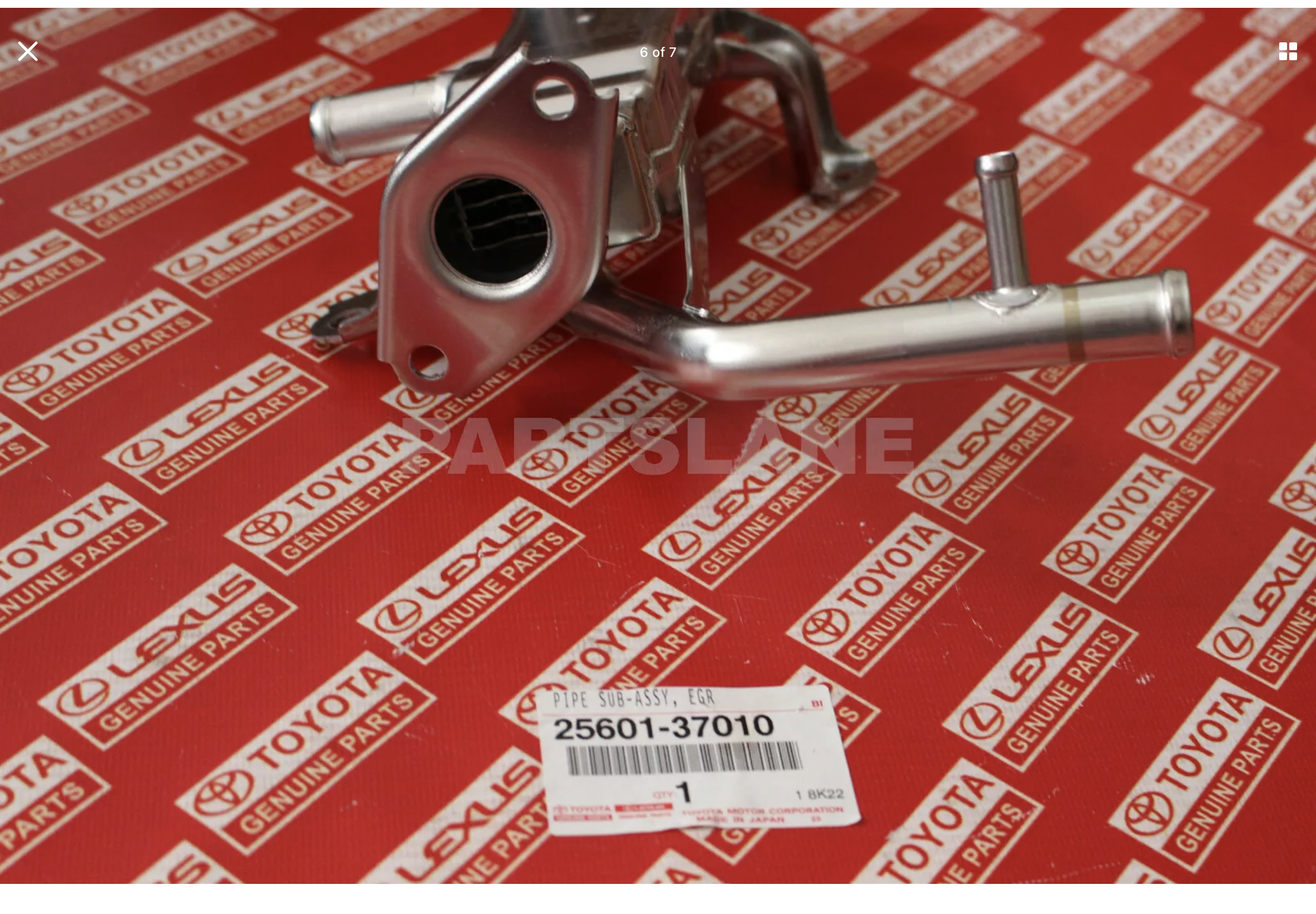

The Workshop Controller at the Toyota Main Dealer I use said there was a major redesign of the EGR cooler when the Prius had it's 2012 facelift.  He said they see virtually zero problems with these modified EGRs.  I'm assuming this modified EGR system was also used in the Auris at the same date.
Well that’s a good news then, all you can do is just replace the egr cooler on your Prius and you have upgraded Toyota 😉, that’s what I will do when I reach 200k miles. Just checked the parts numbers and they are different and inside the design is different so will no need cleaning for much longer time.
Thanks for the info.  Good to see how Toyota learned and improved their products. 👍
Here pictures of the pre 2012  part number 25601-0T020 and post 2012 part number 25601-37010
