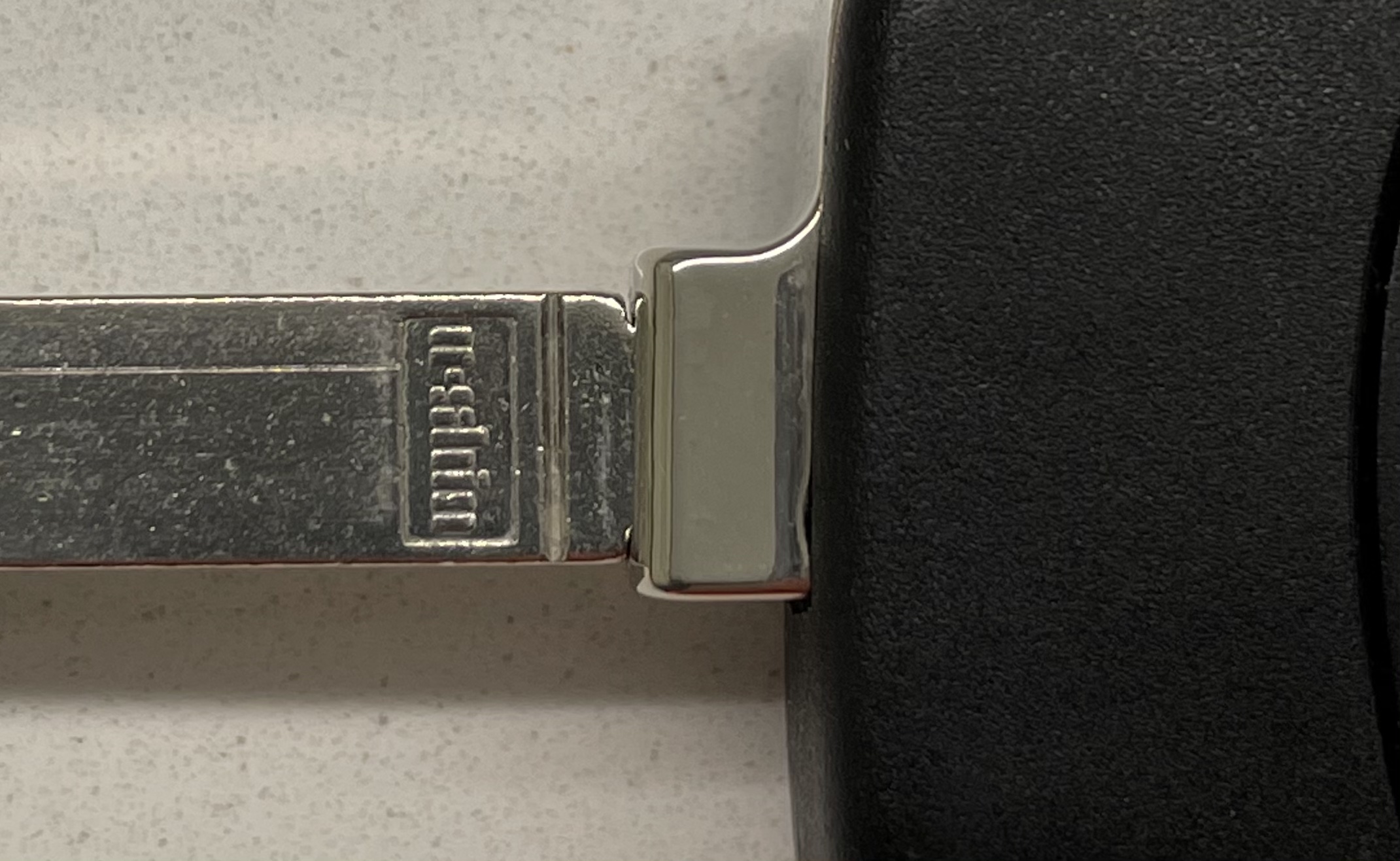

i think even in the USA both models were used, so i doubt it's area exclusive.
I think the only difference is <2018 is G, and >2018 is H, indicating a newer model.
Does you key have anything stamped on it?
Thanks for replying! Based on my searches everything after 2013 should be H-key.
It has this writing that I cannot read. I’ve attached a pic.
