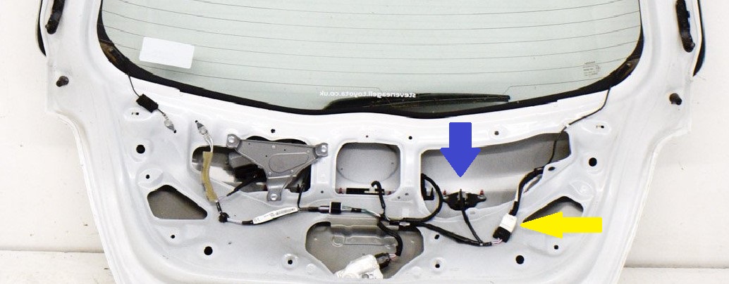

I have the lowly Cool version of the 2015 Yaris Hybrid that didn’t come with a reverse camera.
I swapped out the head unit and the kit I bought included connections for the OEM camera. I have a spot on the rear hatch where the camera should be and I see I can buy one on ebay but what I can’t figure out is how to get the cable that needs to be run from the cam to the head unit.
The cams have this proprietary connector. Has anyone done this or does anyone have a part number for the cable?
Have a look in the tail gate and see if  the connector is there - it maybe taped to the loom, if it's not there you will need to wire it in, up through the tailgate, through the rubber into the car, down the C pillar, it needs to be run in shielded cable
you may find it easier to fit an aftermarket camera
PS. the wiring is part of the body loom
So I just checked it and there’s a connector with three pins ... looks like that’s the one! Then I only need a cable from that to the camera, like 15cm.
It will be the square connector for the camera if it's there otherwise its part of the tailgate loom
Yellow arrow - how many pins does this connector have if present
