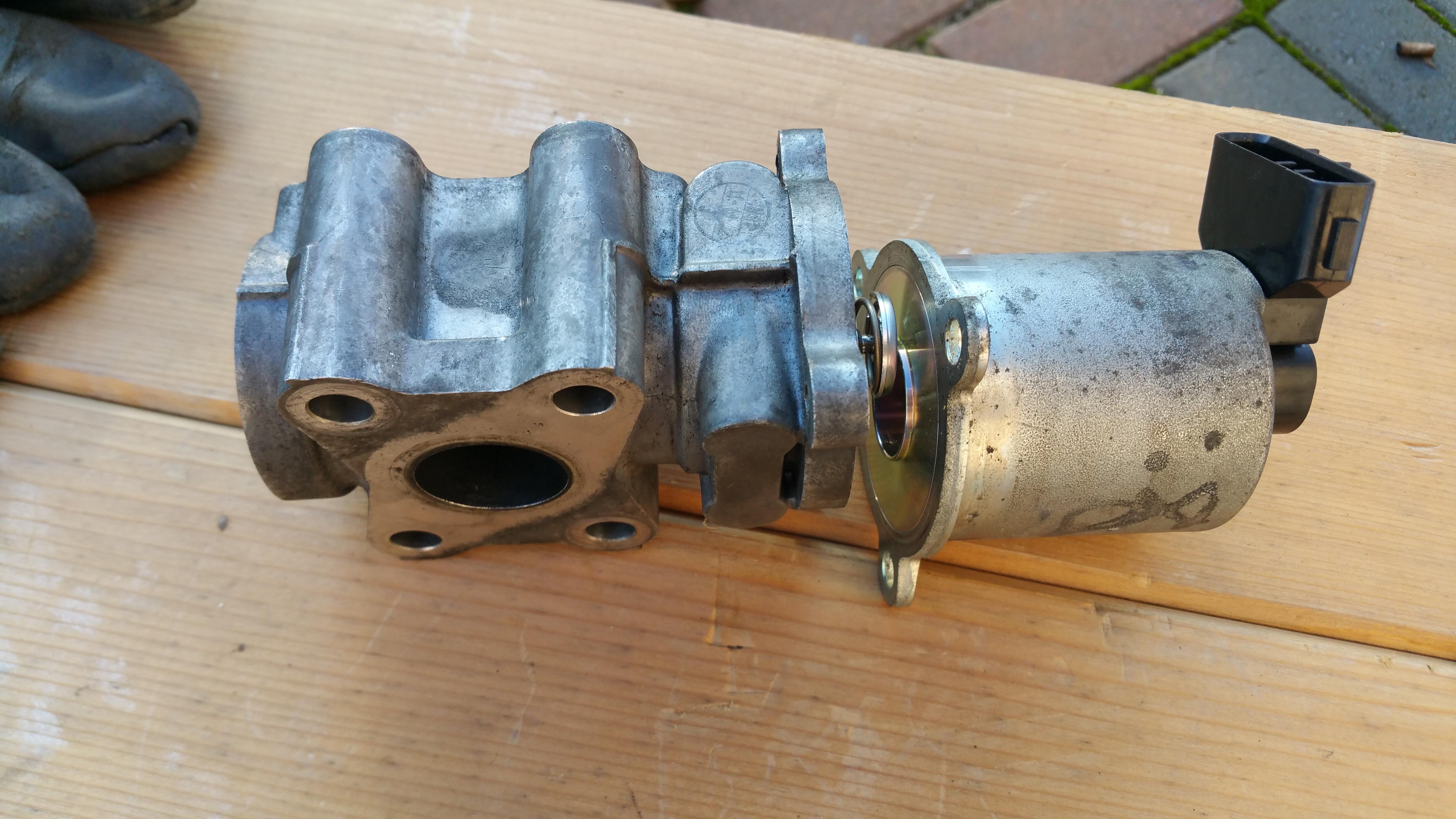

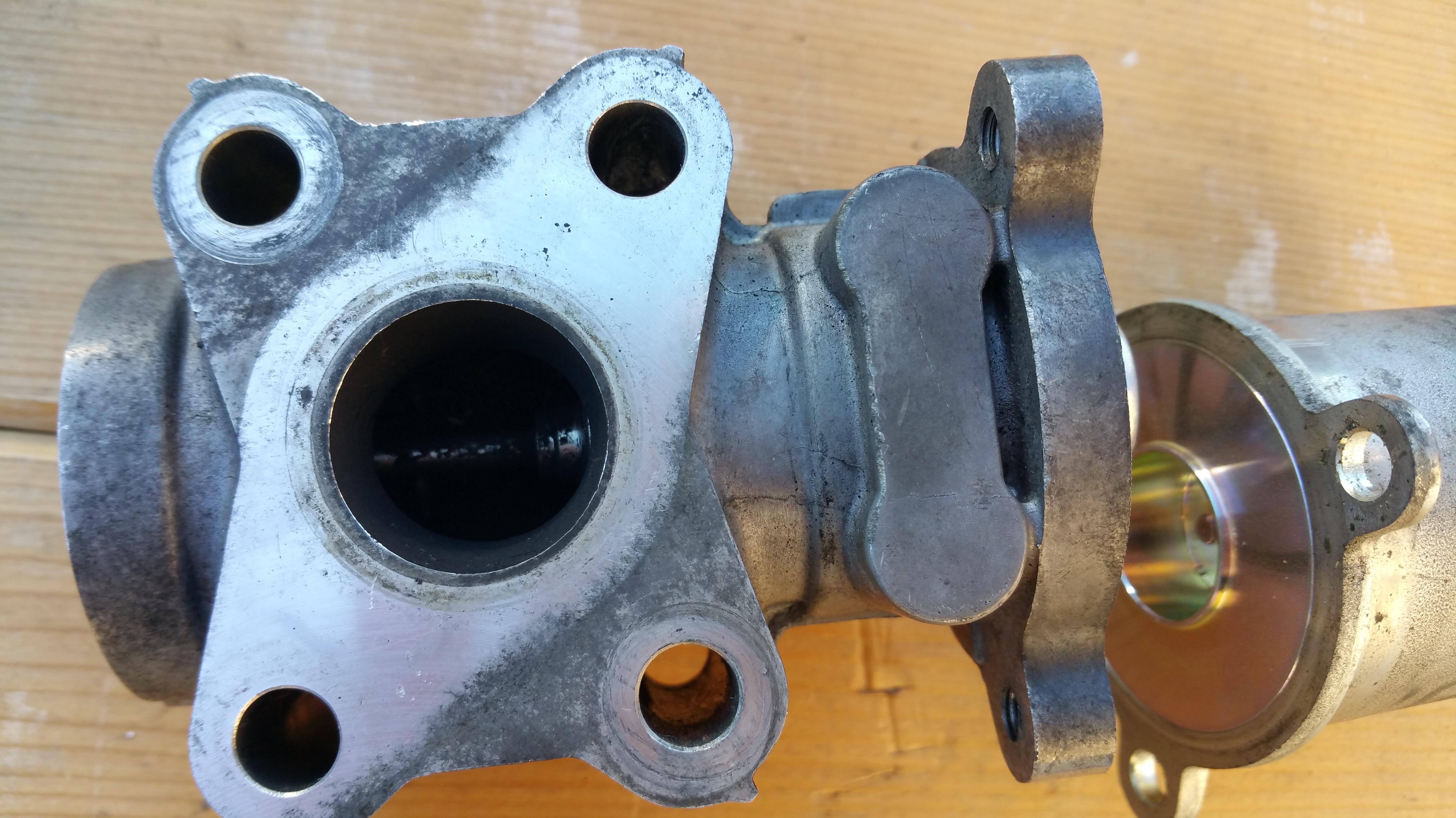

Well I cleaned out the EGR valve - which was very coked up - and it made no difference to the bottom end, but seems to have given it a real kick at around 2,200 rpm. I wasn't expecting that! And I don't know if the soot acts like an old school choke, but it doesn't start as instantly from cold as it did!

I tried to upload some pictures of the soot, but it wouldn't work.
